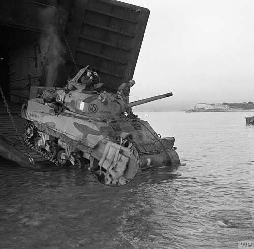

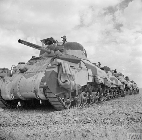

Does anyone know what this item is that is seen hanging off a good number of British tanks in North Africa and Sicily?
Name:	IWM E 18377.jpg
ID:	140957Click image for larger version
Name:	IWM NA 4262.jpeg
I’ve also seen it on some Crusaders, and it never seems to be rolled up more than in these two photos. I can’t work out what it is, or is for, let alone how it’s actually constructed. It seems to have two thin panels on one side and a larger, padded part on the side that’s always towards the tank?

I realize now that the pictures were enlarged on just the item in question. I see that the item is about the same size as a large pack.

Could only have been used in the desert as it would have been torn off in the first 30 seconds anywhere there were bushes and trees.
Also, they always seem to be hanging from the Sunshield rails (the ones for the lorry disguise), which were not present on tanks elsewhere except those that had served in North Africa, too For all I know the item was on a lot more tanks but stowed somewhere else, where it wasn’t obvious.
Just looked at hundreds of tank photos and the only ones I can find are related to landing operations.
In addition to the Shermans and Crusaders in the middle of the desert, you mean? The first photo I posted is of a Sherman around the time of El Alamein, the crew would hardly need a life vest there, I think. Also, just one life vest per tank seems a little … under-equipped? if that’s what it is — which I doubt.
Ah, yes, sorry — I had put a zoom tool over the item in question to show it better. Maybe I should have made that clearer. Here it is at normal size on Churchill as it came ashore in Sicily:

I have done a bit more research on those mystery equipped tanks.
The photos above show the tanks of the British C Squadron, 3rd CLY (County of London Yeomanry) lining up and loading onto the landing barges for the invasion of Sicily. The exit shots are of them debarking in Sicily.
I have found several photos of tanks in the same regiment at the same time carrying no similar equipment.
Just a wild guess is the Squadron commander was a bit of an innovative chap and organised rafts (from the Air Force or Navy?) for his boys for the sea crossing and landing. Obviously whatever they are, they are very temporary as the dozens of photos of this unit in subsequent days after the landing display no such equipment.

There’s just one photo of a 3CLY Sherman in there, AFAIK, and that’s of the one exiting the Landing Ship, Tank on Sicily. That photo is why I’m wondering about the mystery item in the first place: for a model of that particular tank
When I began wondering what that thing is, I started noticing it in photos of tanks in North Africa as well, and that’s why I included a picture of one of the El Alamein Shermans: to show that it wasn’t a thing specific to the Sicily landings.
