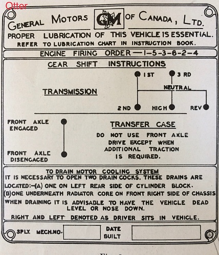

Question: What model GM CMP with a single speed transfer case would engage reverse gear by shifting to the right and down?
My reason for asking is seeing a 1942 GM gear shift instruction plate which indicates that - sorry, no picture available.
Thanks in advance.

...and the C15TA. If you have an original plate for sale, I would like to line up in the queue...
Old 26-03-25, 07:11
Posts: 4,189
Hanno.
As always there is slight differences in the shifter plates.
Both line drawings are from the maintenance manual.

Old 26-03-25, 12:05
Thanks Jordan.
Doesn't the Otter have a high/ low transfer case?
Old 26-03-25, 15:00
Posts: 4,189
Hi Hanno
No it used the same as the C15A
Old 27-03-25, 11:25
That's what I thought. So what's up with the first plate? Could it be an incorrect draft misused as a drawing in the manual?
Old 27-03-25, 19:33
Posts: 4,189
No the first drawing is for the Otter.
This is what an original Otter plate looks like. Not mine
