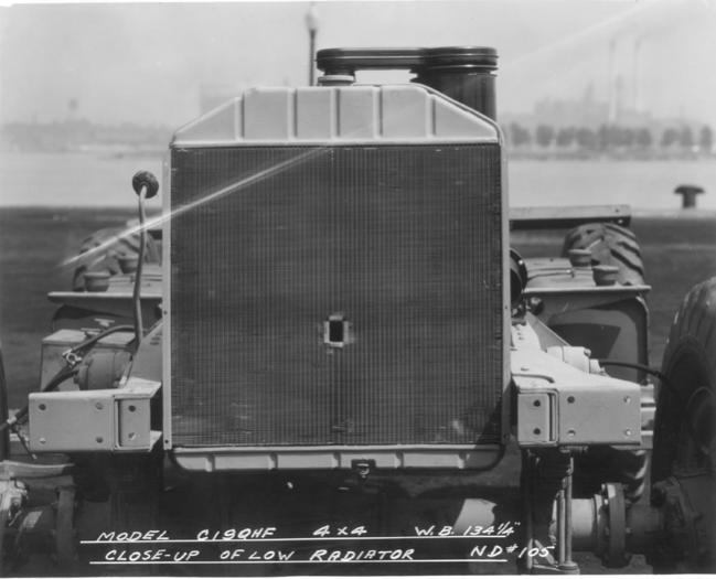

The Indian Pattern 4x4 Armoured Truck has a low nose, necessitating a low-mounted radiator. If you take a close look at the C291QH chassis, one will note the radiator is mounted lower in the chassis, like in this C19QHF chassis:
ID:	69813 Click image for larger version
According to the manual it has a single 12-1/4 gallon tank plus an auxiliary tank of unknown size to be installed when the hull was fitted.

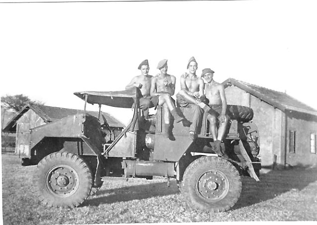

Seeing the low-mounted radiator reminded me of another Indian Pattern odd job: the so-called Indian pattern FATs with "armoured cab":
ID:	69842 Click image for larger version
ID:	69845 Click image for larger version
Note: I don't think it was actually a Cab 13 clad in armour, but rather a makeshift Indian cab. The cab looks too thin for armour plating, it is not rivetted and there is no armour in front of the radiator.
But I am now pretty much convinced these were based on the C291QH chassis. Just compare the level of the front edge of the cab to the top of the radiator on the bare chassis:

The makeshift Indian sheetmetal cab makes sense when out of 480 chassis delivered a number were not converted into the Indian Pattern 4x4 Armoured Truck. Not having any cab components, they must have made up a cab from mostly flat segments, and fitted it with the cargo body normally found on the Indian Pattern FAT.

The 1941 C19QHF was134 1/4wb. Modified from CO1QF 3 ton Chassis. This had 4 full sized fuel tanks.
Lynn,
Indeed, see pictures of the C19QHF below. Do you know for what type of vehicle this chassis was used or intended?
ID:	70064 Click image for larger version
ID:	70065 Click image for larger version
ID:	70066 Click image for larger version
