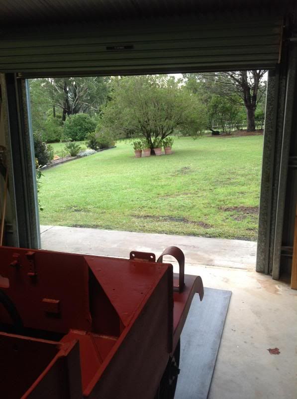

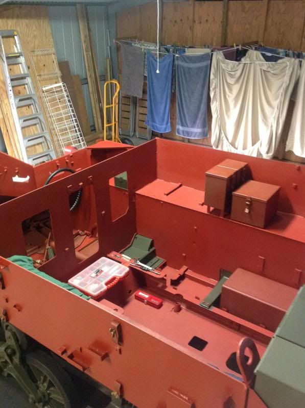

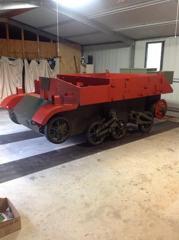

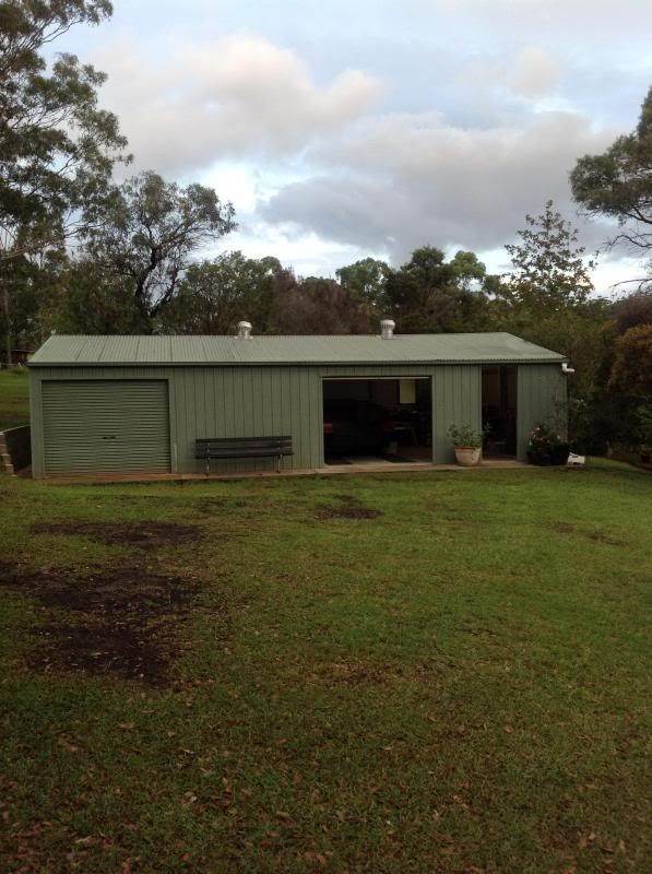

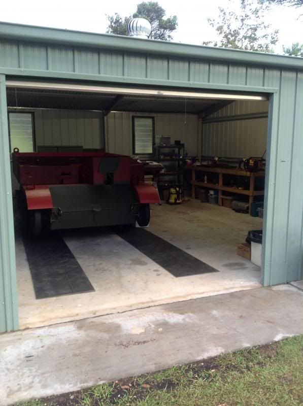

Ok I've got the old photo bucket sorted out . Here are some photos of my new shed it's about ten years old very dirty and dusty from the old owner of the property , must have been a wood worker lots of caked on red dust and spider webs , rats nest etc , plus ply over half of the walls so I strip it out and pressure cleaned every surface look like new now . This is my first ever shed I've only been waiting 52 yrs for this I've been working under a car port with my carrier for the last eight month I have to tarp her up everyday , what a pain in the ass can't believe how good it is to work in a shed. It rained all day today so I have test fitted some of the parts to the hull just to get a feel of how she will look , all's good from now on , shed is 12 mx 7 . I end up with 9m x 7m for my toys the rest is for house storage . Dale
[URL=http://s74.photobucket.com/user/Teeshy123/media/photo_zps42903390.jpg.html][/URL

Default Nice Shed
I wish I had as much room as you. My current garage is only about 11' x 21'.
Carrier is pretty much all that fits in it with just enough room for tool boxes, furnace, work bench and welder.

Default Shed
That looks great Dale, wish I had something like that!
I see you have a good supply of cloths and rags hanging up there to soak up all the oil.

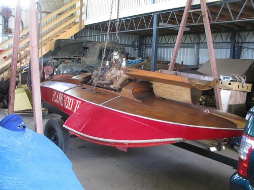

I am lucky my garage is 30ft x 30ft with an RSJ centre so I can lift engines in via block and tackle and a skate which runs along the RSJ . Here is a pic when it was still under construction.... Even that isn't big enough now that the lathe and all the kit is in there !

Default Clothes line
Originally Posted by Dale Jordan View Post
Thanks Keith .. " wish I had something like that " Keith do you mean the shed , carrier or indoor cloths line ??? . The indoor cloths line was a small part of the deal with wife , to be able to have the rest of the shed only gave up 600mm not to bad , Only thing every time she comes into the shed I can see her mind ticking over for a take over of more space , I had better fill it up fast ..Dale.
She will be happy with the clothes line until she notices lots of crap on the clothes from grinding steel or paint removal from old parts.

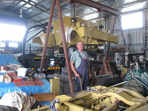

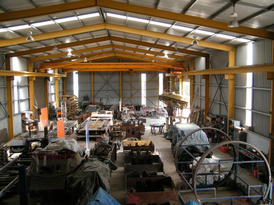

Dale, great clean shed, I seem to remember when my shed was as neat as yours. Nowdays it is rather full. My mobile gantry is over 3.8m. high and we are able to lift a fair weight.

Here is the Lynx hull suspended awaiting the chassis to be rolled, on a set of go-jacks, under it for the final time. A 3 point lift using the Leyland No7 set at the rear was all we needed to get the required height. We used the gantry to lift the original engine out of the speed boat into which it had been placed in 1958.

Fantastic shed Rick. I see what you mean about they are never big enough . I remember you telling me that before when talking on the phone . The lynx's looks amazing sand colour looks spot on . Rick any change of a photo of your carrier which I think is 2250 close to mine I know you have not started it yet but still would be nice to see where it's stored . Dale

My Shed isn't as big as Rick's, but here is my home made slap together gantry.

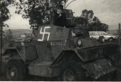

Andrew, I was just updating my Lynx register and listed on the thread below, some info on your Lynx.
http://www.mapleleafup.net/forums/sh...ad.php?t=21839
Your hull should be No 2025 which is the newest listed hull number on the Army Registration Numbers lists at the Australian War Memorial. (Not the last ARN though. I have that one, ARN 123980.)
I also have a photo of 123970 for you. Obviously post WWII and not so loved. I cannot make out the makes of the car in the back ground, but one looks like a Falcon Station wagon, or an EH Holden so mid 1960's.
