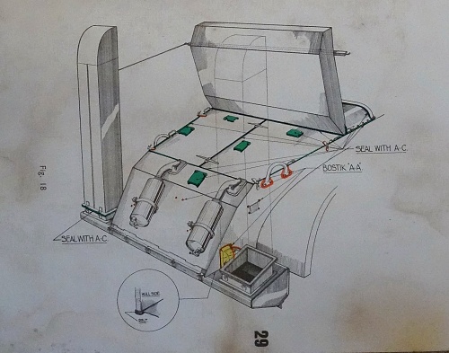

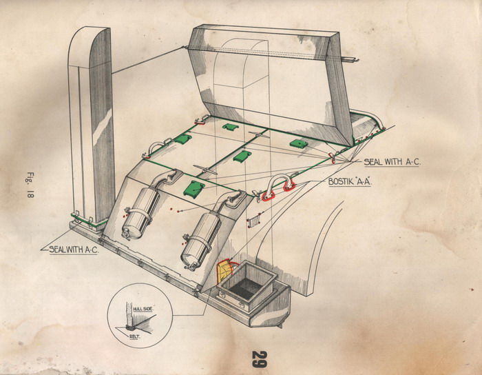

The rear box and the beam across the rear are part from the 4ft deep water fording kit.
When fully installed, 2 stacks were mounted on top of the square flanges and these would extend above the waterlevel so the engine cooling air could flow out.
On the air inlet grill a similar stack was installed.
All 12th Manitoba Dragoon Staghounds were fitted with these kits in England in May1944.
This meant a couple of days work.
12MD had a dry landing on 8/9 July 44 in the St Croix sur Mer area and the vehicles were dewaterproofed the next two days.
The rear box stayed in place on many 12MD Stags as these were difficult to remove in the field (welded on the car).
Also, the box prevented dust being kicked up by the cooling air which normally expells downwards on the road.
The mesh guard is a field modification to prevent things
dropping in the box and becoming out of reach.

Here is another diagram from the fording kit instructions book.
I have rebuild a Staghound (T17E1) in 10 years time and have been collecting (wartime) documentation on this car also.
It is amazing how many publications there are on this car, originating from Chevrolet (Factory manual and "Product Notes") , the US Army (TM-series and Ord9) and the British army (Training Pamphlet and deep water fording instructions).
All are on T17E1 but I'm sure there must be information on T17E2 also.
I also have some British in/exterior stowage diagrams which might be interesting for you as a modeller.
If so, let me know on m.hogenkamp@hetnet.nl
I can sent you these.

Do you know the function of the small rectangular flaps coloured green in fig 18 that you posted?

Now on the green flaps in fig 18: the top two flaps, nearest to the air intake chute, are for refilling the radiators.
The centre two are for refilling the engine oil.
The lower one between the mufflers is for refilling the main fuel tank.
In order to refill the transmissions, the engine covers had to be opened.

Default 4-Ft wading instructions for the armoured car, Staghound, (T.17.E.1.)
Originally Posted by marco View Post
Page from Chilwell Catalogue 72/533, "4ft wading instructions for armoured car Staghound T17E1".
Here are some more scans found on http://www.12mbdragoons.com/stag04.html (likely to have been supplied by Marco).
"Chilwell Catalogue 72/533 titled “4-Ft wading instructions for the armoured car, Staghound, (T.17.E.1.)."
