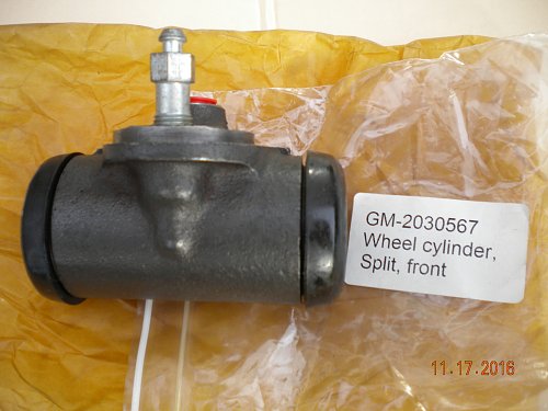

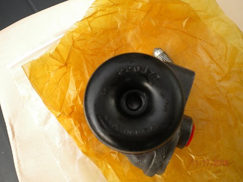

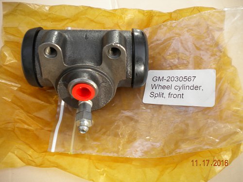

here are some pictures of GMC wheel cylinders for comparison:

Old 20-11-16, 20:32
With a recommendation from Rob Love, I bought mine from Rock auto. (U.S.A) They were about $32 or $38 each to buy (they were on special-then there was post) but the purchase price meant I could buy four sets for the price of getting two old cylinders sleeved in stainless. I was also having trouble locating the correct boots.
Note. The CCKW has a few variations, using either Timken or Banjo axles.
This style of cylinder (Hanno's pictures) only fits the front axle of the Timken type. This axle has the Wagner Lockheed single leading shoe. All the others are twin leading shoe and Delco type brakes, with the metal star wheel adjusters as part of the wheel cylinder assemblies.
