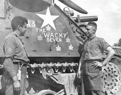

How about this one:
http://web.inter.nl.net/users/spoels...s/dnd36069.jpg
Source: The Public Archives of Canada (DND Army 36069); courtesy of Peter Brown; picture linked from THE PRIEST KANGAROO
Caption: 'Priest' self-propelled gun of the 19th Field Regiment, R.C.A., Normandy, July 1944. [Left to right]: Bdrs. D. Nashawa, G. Harper. Full names of 'the "Wacky" Seven are - top row painted directly onto the hull side DICK and GORD, second row on Maple Leaf background HARRY and JIM, third row also on Maple Leaf background BERT and BRES."

Hi Hanno,
I have a print of this and both Dick and Gord are also painted on Maple Leaves. It loks like the leaves are of different colours (at least three) and may represent the men's original divisions (red for 1st, etc...)
PS did you get my PM?

Default Re: the "Wacky" Seven
Caption:Full names of 'the "Wacky" Seven are - top row painted directly onto the hull side DICK and GORD, second row on Maple Leaf background HARRY and JIM, third row also on Maple Leaf background BERT and BRES."
Seems they can't count. Crewman No 7 is "Ken", between the legs of the allied star
