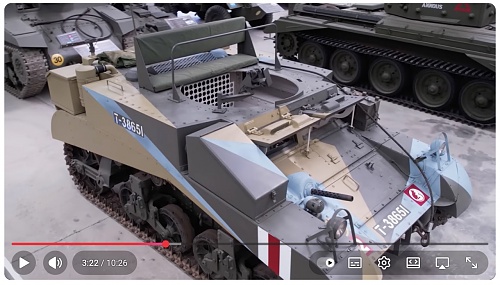

![]() https://www.youtube.com/watch?v=QygmAugFRA4 |
