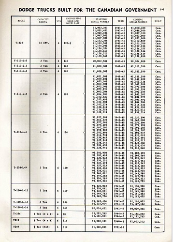

Lang,
I was not aware of that book, but your image lead me to this version from 1952:
https://armyvehiclemarking.com/wp-co...compressed.pdf
The “Dodge Trucks built for the Canadian Government” can be found on page 9-1.
My calculations indicate a total of 28854 T-222 (D15) built. Upon review, I realize that my calculation excluded one vehicle in each block of serial numbers. The correct figure should be 28866.
Note: If someone has the ability to add page 9-1 as an image I believe it will be a useful reference in the future.

Lang,
Here is that page:

Hanno,
Thank you, I have feeling that page will be a handy reference for any future WW2 Canadian Dodge production questions.
Colin

This evening I managed to get my hands on the pictured parts book. It was published June 1, 1945 and covers the entire production run.
The title page also includes the list of serial numbers and the associated contract number. (This list covers all of the same serial numbers as the later Chrysler Serial number book, but breaks up some of the sequential blocks into separate contracts).
I now feel quite confident that the complete production run included 28866 vehicles. (I amended my calculation above as I miscalculated and excluded one vehicle from each serial number block).
