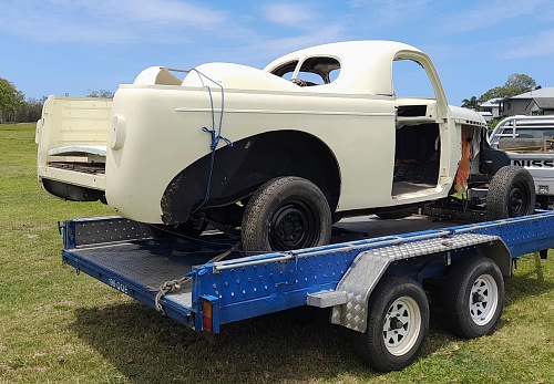

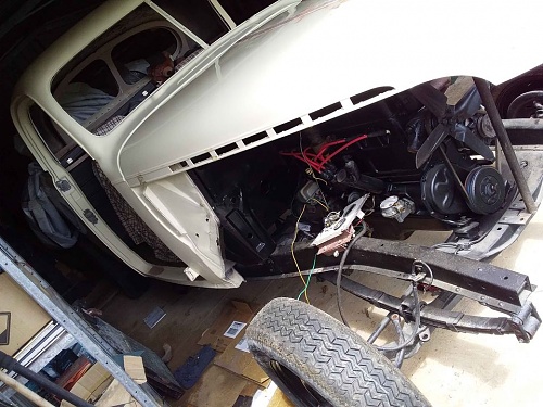

Just got it home
Name:	Chev Utew1.jpg
ID:	132130 Click image for larger version
Name:	Chev utew2.jpg
Old 10-01-23, 06:31
Posts: 5,963
Default Nice
Just got it home
That's a beauty ! looks like somebody has done all the hard work... these are quite rare , the production numbers were very low compared to the overseas models which were produced in large numbers, GM-H were a relatively small setup.

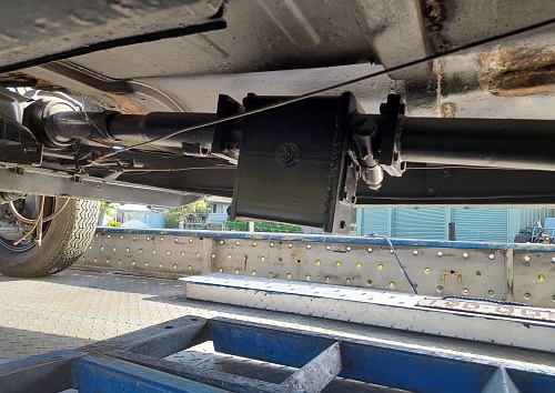

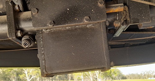

Just for interest has anybody ever seen one of these overdrives and what make? Not a 5 minute job to fit to a torsion tube. It will save me finding an overdrive gearbox.
ID:	132135 Click image for larger version
ID:	132136 Click image for larger version
Attachment 132135 Attachment 132136 Attachment 132137
The engine nr. seems to be correct for a vehicle of that vintage . David Hayward's site would help you but the site seems to have disappeared. The 216 evolved over the years from 1937 until the early 1950s. There are different heads and valve lengths to consider if you are buying spares and different water pumps.
This might help http://hotrod.gregwapling.com/chev-t...dian-chev.html
FOR WALKERVILLE CHEVROLET MILITARY TRUCK ENGINE NUMBERS 1940 G.M .OF CANADA USED SEVERAL SEQUENTIAL SERIES FOR EACH PREFIX AKIN TO A CODE FOR EACH TYPE OF VEHICLE: THOSE KNOWN INCLUDE “R” [CAR] “AR” “CR” “FR” “PR” “SR” “TR” “WR” “ZR” WITH THE “R” FOR R.H.D. MOTORS AND ALSO “TRA” AND “TBA” AND “TBRA” IN 1940 FOR “TRUCK, RIGHT HAND DRIVE, ARMY”; “TRUCK, BUFFALO -ASSEMBLED, ARMY” AND “TRUCK, BUFFALO-ASSEMBLED, ARMY, RIGHT-HAND DRIVE” WHEN “B” FOR “BUFFALO” RERESENTED THE TONAWANDA, NEAR BUFFALO, NEW YORK STATE, ENGINE PLANT. THERE MAY ALSO HAVE BEEN “KR” ON ½ TON GMC TRUCKS, BUT “WR” HAD NOTHING TO DO WITH “W” WINDSOR-BUILT GMC 224 UNITS.

The overdrive unit almost looks like a backyard engineered device. Whoever made it , they were clever.
