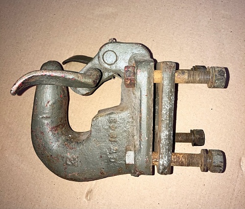

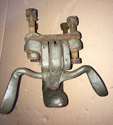

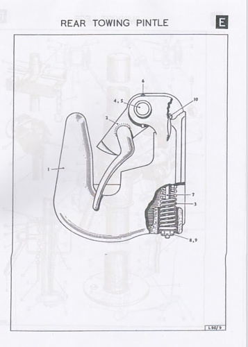

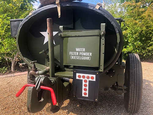

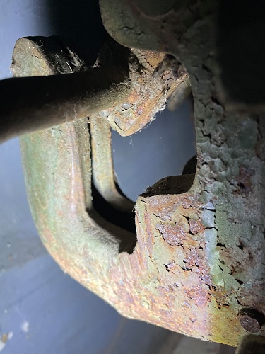

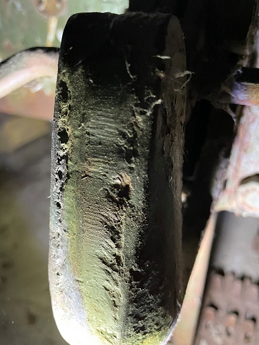

I picked up a pintle recently. While it almost looks the same as the pintle on my F15A, the levers to open it are different (besides being bent as you can see).

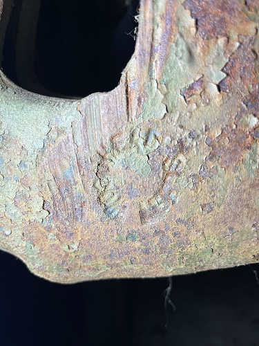

It is marked "GW 1943" and it looks to match the "towing pintle" drawing from a British trailer parts list.
Can anyone confirm it is British?

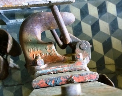

Commer? http://www.mapleleafup.net/forums/sh...802#post278802
https://images.app.goo.gl/P5J5rWgBFgWRjrU36

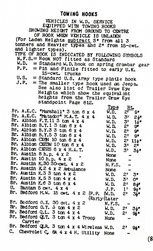

Default Standard W.D. hook on spring drawbar gear
Thanks Mariano,
It turns out it must be a standard British W.D. towing hook as fitted on a spring drawbar to many trucks.
Name:	W.D. towing hooks.jpg
Source: CMP's and attaching trailers......

Agree Hanno British, similar to my Morris

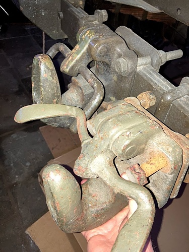

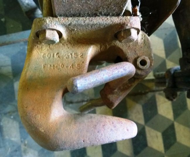

The Canadians saved time in making a pair of simple horns and not as molded as the British, right?

I have noticed the different hitches on some of the artillery limbers at work.
As compared to the British ones, the Canadian ones merely skipped having to heat and press the ends of the two handles.
I also have a hitch out in the shed that is fabricated rather than cast.

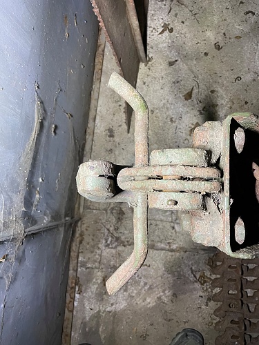

One that came with the limber i bought.

That’s a Canadian hook because the lever is made from round stock.
