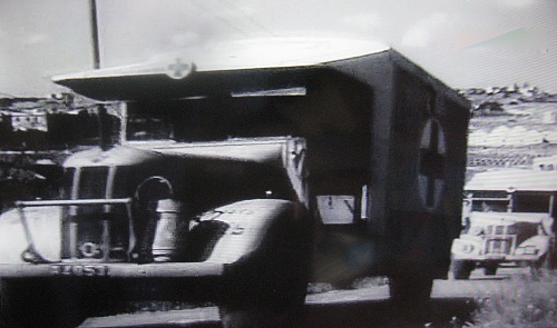

David, all the photos show the pipe passing through the cap into the condenser, presumably they could rotate in the tube in the cap to allow the cap to be screwed and unscrewed.
Lynn, thank you for the background on condensers. The anectdotes (which I am always open minded about) about water/steam venting from the condenser/radiator are interesting, and at odds with your comment about the damage that would do to the alcohol thermostat. I don't know if they 'upgraded' the thermostat in any way in the field or with the initial order for the trucks. but it looks like they upgraded as many features on the truck as possible to make it more robust and reliable when they placed the original order in 1941. The General Motors agent in Alexandria was consulted about the original order and most likely suggested various upgrades based on his experince of Chevrolet trucks in use in the Middle East and with the Egyptian army. I don't know if there was an option for the thermostat in the GM catalogue at this time, but the likelyhood of overheating was considerable on operations. They ordered the uprated radiator with shroud, and also had the 18" 6 bladed fan to help with cooling.
I'm also trying to work out the different sizes of these cans, and the correct details of all the mounts and how they were fitted to the 15332 truck. Photographs mostly show only a vertical metal strip bolted to the top of the bonnet/hood, and bolted below the can. Some show a horizontal strip in front of the can, presumably to prevent the heavy can swaying on the bracket.
The first photo shows S11 SIPOLILO of S2 Patrol. This truck has the base of a CMP seat bolted to the top of the stowage chest access hatch behind the front passenger, a more comfortable method of seating on the long patrols for the rear passenger, and not seen on any other truck in the LRDG. The worried looking bloke is an Italian POW. The boots do look like they are in an awful state.

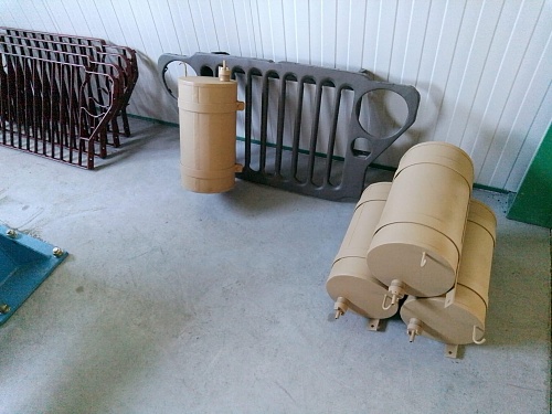

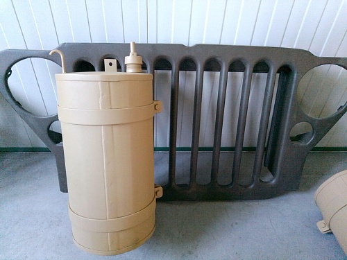

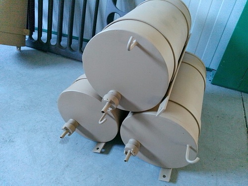

Frédéric Durras in France builds these replica expansion tanks for replica SAS Jeeps:

And grills for slat grill Jeeps, by the look of it. Dimensions would help to work out the capacity of the tank. 6 1/4 gallons to the Cu.Ft. Metric is easier.

I had a go at working out the dimntions based on the early tanks being 2 gallon POW cans, as the Austin ambulances had these fitted later in the war,
I guessed at 7 5/8" dia x 13 1/8" tall,
the small expansion pipe being 235 mm long running down the side of the tank,
othere sizes were 105 mm dia X 205 mmm high,
looks to be tin plate seams top and sides

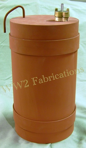

Yes, the ones I posted above are made by "WW2 Fabrications" - see https://www.ww2fabrications.com/british-saslrdg
Radiator condensor cannister
Condensor as fitted to the front grill on the SAS/LRDG Jeeps in north Africa. £120.00 plus P+P. (please note these are dummies for display purposes only)
