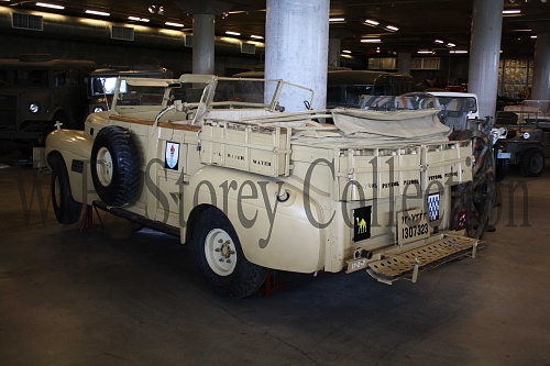

Field Marshal Alexander's car in the Canadian War Museum has some mounted on the back and it may be possible for someone to get permission to photograph and measure them once the museum reopens to the public. This is an old photograph from 10 years ago so I am not sure where this vehicle is currently located within the Lebreton Gallery

Old 26-03-20, 18:10
Posts: 3,682
Interesting photo, Ed.
I wonder if there is a correct way and an incorrect way to stow these channels on a vehicle?
On Alexander’s vehicle, the two channels are nested into each other and look at the big gap between them and the retaining bar that is supposed to secure them in place. At the very least they would make quite a noise sitting like that when the vehicle was on the move, if not get lost altogether.
When you look at the earlier photos posted, you see some vehicles where the two channels are cupped against each other and fit snugly into their stowage brackets in that manner. On the other vehicles, the channels are nested when stowed and have extra web straps added to hold them in place, with lots of extra space in the brackets.
Interesting.

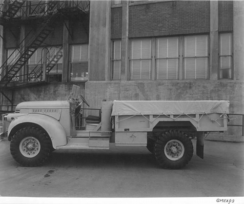

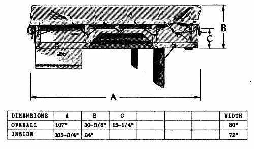

All very interesting points, and very happy to see another photo of the smaller channels... It totally makes sense that they would exist, as did the larger size. As to how to properly carry them without loss and having them rattle their way down the road is another matter...
I believe that we were trying to ascertain the original dimensions of the larger size channels... While looking for this answer, I thought that one big clue would be in this first photo... If you compare it to the diagram, these should be as wide as the distance between C and B in theory, except...
1- We don't know if the truck in the photo has the bed in the diagram...
2- We don't know width of the channeling that surrounds the box...
But could come close... The difference between C and B is 15-1/8 or 384.17 mm which might just be the ticket and what my friends Chuck, Bob and I came up with...
As for the length, somewhere in the 81" or 6.75' seems in proportion...
I know there are some out there, but someone willing to help has to come up with the information...
66154416_10219602675928006_567208314711048192_n.jpg   71761684_10156567636713148_4582547104865452032_o.jpg
Old 27-03-20, 19:54
Posts: 14,946
Default 4B1 body
Yes we do - the diagram shows the general arrangement of the 4B1 body, which was designed for mounting on the Chevrolet 1533X2 truck.
