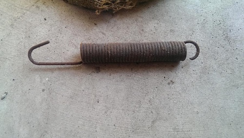

Who can supply the basic dimensions of these coil springs? Overall length, diameter and wire gauge.
Also the size of the washers, please.
I'm sure these, or ones very similiar, can be bought off the shelf somewhere?
Thanks in advance,
Quote from nos bag of cmp seat springs:
Originally Posted by Peter Duggan View Post
It takes two different lengths is springs to do a seat back.
Name:	cmp seat back coil spring.jpg

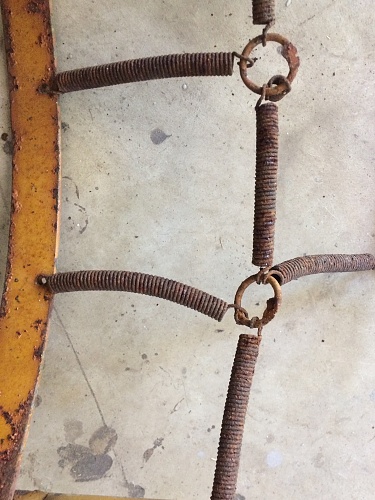

Here are the measurements of the spring on my C8 1940 front seats.
Rings (9 per seat)
Wire thickness 3mm
Overall diameter 25mm
Centre springs (18 per seat)
wire thickness 1,5mm
40 coils
Outside diameter 9,5mm
about 85mm overall length including the hooks
top and lower springs (6 per seat)
48 coils
about 94mm overall length including the hooks
The top 3 springs and lower 3 springs are longer than the ones in the centre.
Rings seem to be welded at the end....it's not solder as I heated one and nothing melted....except the skin of my finger
My seats don't have the springs as shown in Peter's picture (with one long hook)....maybe a difference in supplier at the time?? or Ford vs Chev? early vs late?
IMG-20170816-WA0010.jpg   IMG_0381.jpg   spring is my love1.jpg   spring is my love2.jpg

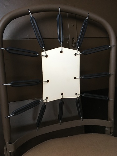

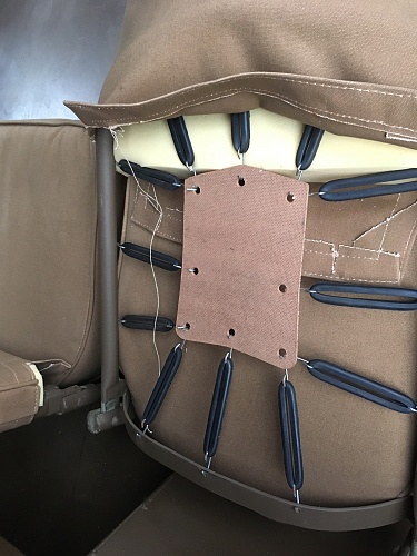

Hanno,
I never did find a source for new springs. I did acquire several rough seats and salvaged enough springs for my driver's seat, and a healthy reserve.
Alex,
Thanks for stepping in and correcting my post about the seat back springs. When I posted that picture, I was at the start of my learning curve. Your measurements and comments mirror what I have learnt.
Peter

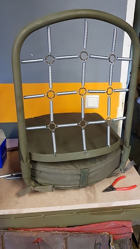

Attached are the rings and springs Hanno and I bought for our seats. Credits go to the Dutch Morris owner that found the suitable springs, as mentioned earlier in this thread.
Both springs and rings are Metric measurements, but they are pretty much spot on when compared to the originals, especially when you take production tolerances of the time into consideration.
I decided to use 1 type/length of spring, in stead of the 2, or sometimes 3, different lenghts used in the originals. I just stretched some of the springs to match the longer ones.....just put a screw driver in the vice; put one spring eye over the screwdriver, and use a second screwdriver through the other eye...than slowly pull and check against the original springs.
IMG_20180920_141035.jpg   IMG_20180926_174507.jpg   IMG_20180928_171500.jpg   IMG_20180926_175520.jpg

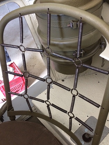

Attached are some pictures of the finished seat back on one of my C8 seats.
Springs used:
https://www.fabory.com/en/helical-te.../p/17902160075
Rings used:
https://www.kleinmetaalshop.nl/ringe...20-x-3-mm.html
The rings are available from different vendors....they have a slightly larger overall diameter when compared to the original....(and the weld is a bit nicer than the original). Size 20x3mm
