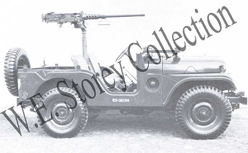

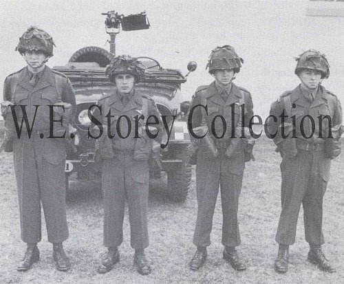

The M31C Mount was an interesting M38A1CDN accessory that in Canadian service was not intended to be used with the M1919A4 .30 cal but with the M2 .50 cal. I have yet to find any evidence of the M31C mount being used on a UN mission. Both photos are from CAMT 7-30.
Name:	Figure 77 copy.jpg
Name:	Figure 92 - Fall In (Mounted) copy.jpg
