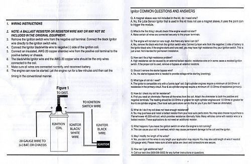

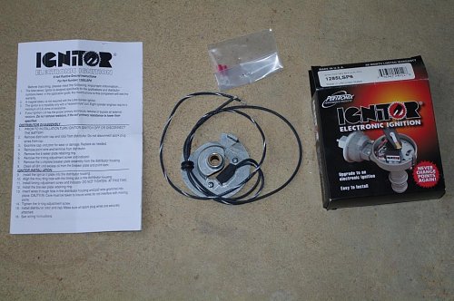

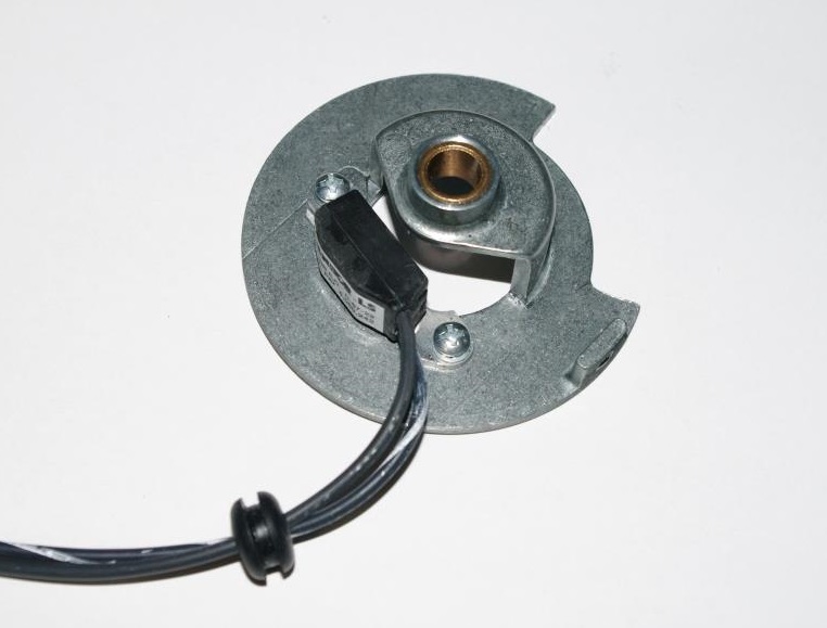

Tony Wheeler's Avatar
Join Date: May 2012
Location: Yarra Junction VIC
Posts: 953
Methinks the distributor has to come off for an inspection.
Perfect opportunity to fit one of these Hanno, and forget about points and condensors forever!
Name:	Pertronix 1285LSP6.JPG
Good "point", is this a Pertronix unit?
Yes it's the Pertronix kit Hanno. I bought mine a while ago but haven't got around to fitting it yet.
