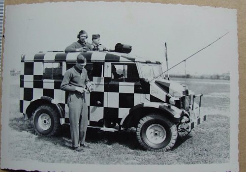

Old 15-09-15, 08:08
Posts: 14,934
This one? Great find!
http://m.ebay.com/itm/Chevy-C8-CMP-C...124?nav=SEARCH
Old 15-09-15, 08:44
Default F8
And it's a Ford to boot!
Old 16-09-15, 03:21
Posts: 5,259
Default I got a bid on it......
Shipping to my UPS address in upper NY is $3.60.
If I get it .... it's yours Gord.......
EPay sucks unless you know some of the loop holes.
..and if I don't..... I think I now have it on my PC.
Hang in there
