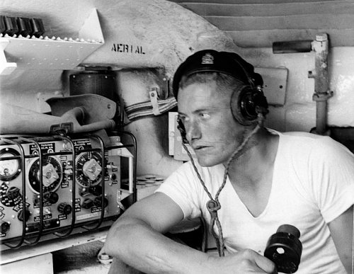

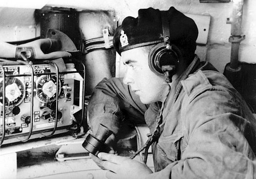

I found this pic on line a while back... does it help?
Was captioned "John Bowles, 4th County of London Yeomanry, Africa, 1943"
Name:	John Bowles - 4th County of London Yeomanry - Africa - 1943.jpg
Also this one "Tommy Elkins, 4th County of London Yeomanry"
Name:	Tommy Elkins - 4th County of London Yeomanry - Africa - 1943.jpg
Tim

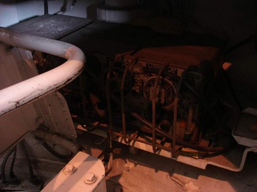

Here is a picture of one in a M4A2E8 if this helps.

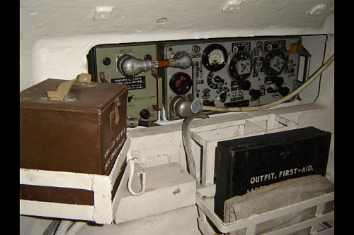

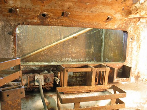

Here is another M4A2 76mm Wet installation,
If you like I can take some pictures of the bare mounting tray that goes under the radio and mounts to the turret rear bustle, mine is out for sand blasting and painting
