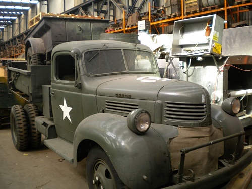

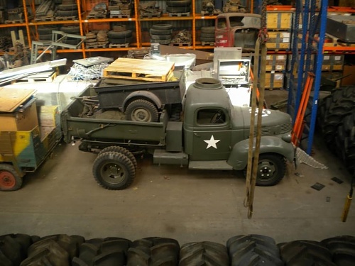

Hello, this is my dodge d60s.
Does anybody have 'original' pictures of this truck?
Just pictures of the same trucks are welcome, because I don't have the storage box between cabine and body. Also the fueltank next to the chassis is missing.
Thanks,
Kurt.

Hello KURT
Pic of D60S took from the side are very rare (pic of truck during the war and after the war). Nevertheless I send you a pic of a modified DODGE D60S take on the left side. You can see the housing of the spare wheel. This truck is for sale 9.000 euros and the rear axle have been modified :single wheel at the front axle (like the D60L5) and dual wheel at the rear.
I think that the EATON axle with two speeds was replaced by an other axle with dual wheels (like your truck).
Actually in BELGIUM , I am in relation with an other guy who is also restoring a DODGE T110 . I hope to find other pic for you
Best regards Serge

Hello
Following the answer of GORDON I would like to add some information about these trucks.
In fact there is two kinds of D60S. Some have single rear wheel and a EATON rear axle with two speeds . In this case the wheels are "british wheels" in two parts with 8 nuts and the tires are 1050X16. I don't know the code D60S ?????
The second kind own dual rear wheels with tire 8.25X20 and they have either an EATON axle with two speeds T110 L6 D60S (following the legend of the book of BART VANDERVEN page 236) or an EATON axle with only 1 speed.
As the tire have different width so the housing can not been the same. I join a pic of a D60S with a funny spare wheel housing but less large than the spare wheel housing the blue DODGE.
About the idea of GORDON to put a spare wheels used on a F60L or C60L I thing that the housing is too large for the truck of KURTS and non adequate because you will have no place for the tools box which is on the right side of the spare wheels housing. The best way should be to use a spare wheel housing of a GMC CCKW352
About the fuel tank there are the same than the fuel tank of lorry with long wheel base. In a future email ; I hope to give the dimension of the tool box
Best regards Serge

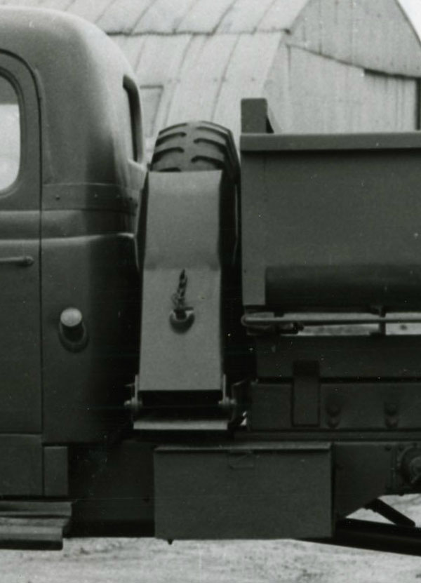

Lovely trucks guys. I think the blue one was on Leboncoin, accompanied by another green Dodge Canada(?)
Attached is a picture from the Dutch army archives. The side shot is marked as "D15" (?). There also is a head shot if you look for "Kipauto".
I have cut a detail of the spare wheel carrier from the bigger side shot.
Source: http://nimh-beeldbank.defensie.nl/

Hello ALEX
The pic you show is a DODGE D60S (not a D15 which not exist with a tipper) with single wheel at the rear axle. It seems to be complete with the exception of the head light not original. The tires are 1050X16 and the spare wheel housing is a little more width than the spare wheel housing for the truck with dual wheels at the rear axle.
It seems that they have no mudguard at the rear for all versions of D60S.
I found the "blue DODGE" on the web sit "SECONDMAIN" and not le boncoin.
Best regards Serge
