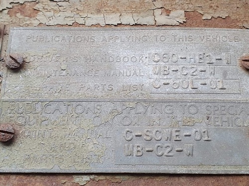

Hello Martin,
Your Chevrolet have once been fitted with "Special Cold Weather Equipment - SCWE".
As far as I know the Canadians had two standards of special equipment for cold weather operations, "winterized" for use in temperatures down to -29 degr. F (-20 C) and "arcticised" for use in temperatures down to -40 degr. F (-40 C). To my knowledge the SCWE is supposed to be cold weather equipment according to the "winterized" standard.
I own 3 Chevrolet C15 delivered under contract SM 6050 which was once equipped with the "SCWE".
I have enclosed a scanned image to show the publication plates according to one of the vehicles and the special equipment.
The "C-SCWE-01" is the parts list for the "SCWE" and the "MB-C2-W" is the Maintenance Manual. I have a original copy of the parts list but have never seen the MB-C2-W. According to the late Peter Ford's excellent CMP-INFOEX the "MB-C2-W" is a supplement to the "MB-C2" Maintenance Manual. But as far as I can read the publication plate for the vehicle the "MB-C2-W" must be a "MB-C2" with the supplement printed as a part of the manual. In the "Drivers Handbook C15-HB1-W" the supplement about the "SCWE" is printed in the book.
Hopefully someone can help to solve the question about the "MB-C2-W".
Lars

Posts: 88
Lightbulb SCWE Parts List
The "C-SCWE-01" looks like this. No illustrations, and only 8 + II pages.
Lars

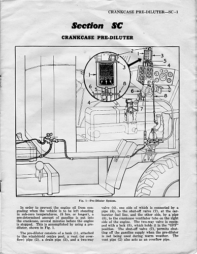

Old 16-10-09, 01:58
Default Cold Weather Manual
As to the artic kit really need to know Ford or Chevy. I have the cold weather modifications manual for the late Chevy Pattern 13s. Which I can scan and post.
Here is the link to the MB-C2 (W)Supplement To Maintenance Manual MB-C2 Covering Special Cold Weather Equipment. http://www.canadianmilitarypattern.c...0Equipment.htm if you click on the image of each page you will see a High Resolution version of the page.
I think this will answer your question about the location of the oil filter in the later Pattern 13 Chevys. Standing the filter unit up right made servicing easier and allowed for a drain tap to drain water condensation out.

Old 16-10-09, 17:21
Default Manual Supplement Covering Winter Equipment
Originally Posted by Fabio View Post
Thanks once more Phil that's outstanding reference for me!!!
Just a little problem: it seems that the last three pics cannot be downloaded in hi res...
Hi All
I've fixed the problem with Hi Resolution images of the last three pages.
This Supplement Covers the following:
  • Cab Heater and Defosters
  • Engine Primer System
  • Crankcase Pre-Diluter
  • Modified Standard Equipment
  • Miscellaneous
  • Lubrication
It helps to explain some of the running changes on Pattern 13 Chevys such as change of oil filter location and size. Those three little pipe plugs on some intake manifolds.

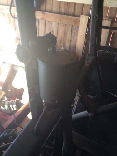

Old 10-06-12, 17:05
maverick maverick is offline
Alan Bumford
Join Date: Oct 2006
Location: Swindon Wilts England
Posts: 93

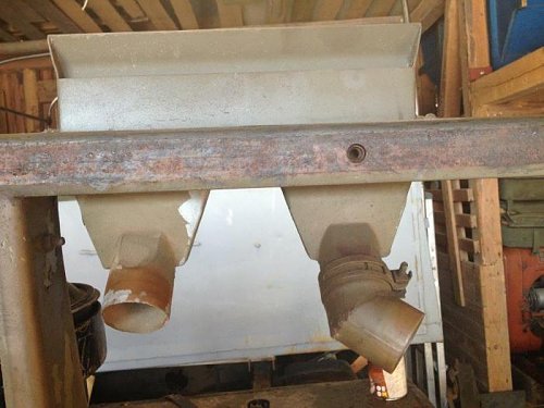

Default Diluter

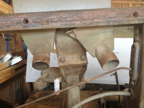

Found this in the shed the tap needs sorting as its seized up but otherwise complete. The question being are they quite common or rare parts to source ?
http://i946.photobucket.com/albums/a...rofmub/001.jpg
Old 10-06-12, 19:26
Default Would Say Fairly Rare - More info
Hi
Here is the link to the Maunual that cover it http://canadianmilitarypattern.com/S...0Equipment.htm
http://canadianmilitarypattern.com/R...%20W%20014.jpg
Old 10-06-12, 21:10
Location: Ottawa ,Canada
Posts: 2,916
Default Arctic kit
Phil..
This was a standard piece of kit for the Arctic rigged Chev and GMC CMP's..
Not only rare but very unusual ..Nice find..
I can't remember if It is in the Ford Arctic kit manual or not....
Grant has the original Ford Arctic Manual so could look it up
Alex Blair
:remember :support :drunk:

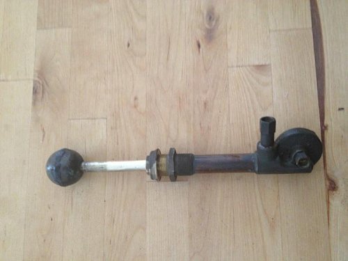

Old 10-06-12, 22:49
Here's a scan from Military Vehicle Profiles. They were used on Ford and Chev CMPs. I've never seen one in my travels if that's any indication of how rare they are.

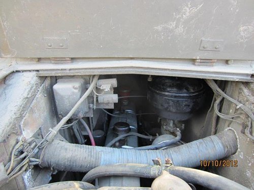

Old 29-03-13, 09:54
Svenn Ryen Svenn Ryen is offline
Join Date: Mar 2011
Location: Norway
Posts: 164

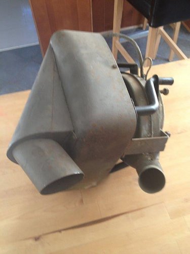

Hi guys.

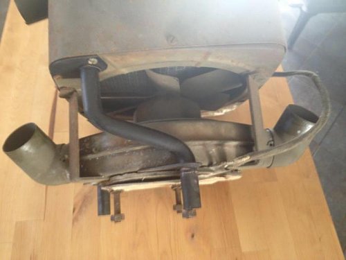

Found this old thread and thought I'd post some pictures of the arctic kit on my CMP. I has primer pump, diluter, personell heaters.
A nice detail is the production month/year markings on the electrical motors.
Here are som pics of the insides of personell heaters.
I will post more pictures later.
Svenn

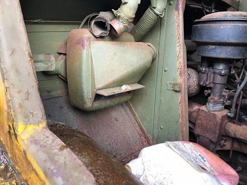

Left side heater, diluter, heater switches and primer pump
Old 29-03-13, 10:14
Join Date: Mar 2011
Location: Norway
Posts: 164
Heater funnels, primer pump and diluter.
ID:	56048 Click image for larger version
ID:	56049 Click image for larger version
Heater ducting and coolant hoses in engine compartment
Primer pump

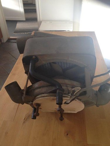

Old 24-04-13, 16:36
Join Date: Mar 2011
Location: Norway
Posts: 164
Default Passenger side heater

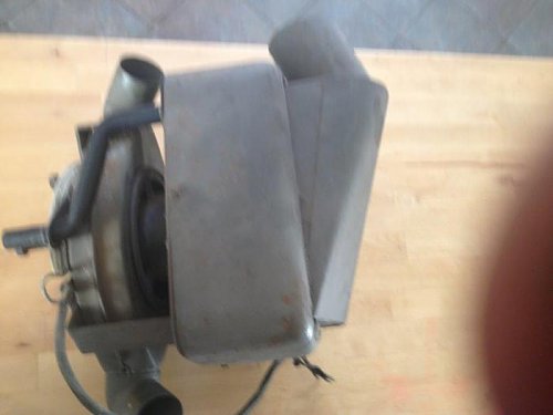

Here are some more arctic kit pictures, this time the passenger side heater.
I have had the core replaced. The construction of if makes it almost impossible to be sure that all coolant / waters has been drained. Mine had a few minor leaks, but a new core has been bulit in.
The fan is driven by a two way fan...so that it can either be used as a window defroster or heat the passengers and drivers frozen feets. I the large outlet leed air throug the engine compartment in ducting an into drivers side.
The smaller heater mounted on the drivers side is only for window defrosting.
Svenn

Old 24-04-13, 18:23
Default Interesting point about the heater unit
Hi Svenn
You raise an interesting point about not be able to drain the heater core unit. In reading through the cold weather equipment manual I don't find any reference to this problem or the need to always run antifreeze in heater equipped vehicles. There are numerous cautions about damaging the heater cores and about checking them for leaks.
Has anybody come across a manual or service bulletin referring to this issue?
Great to see actual photos of a heater unit, thanks for posting.

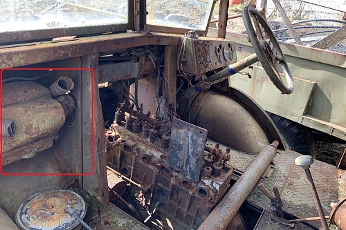

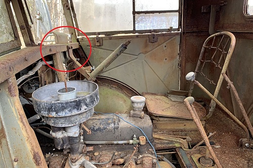

Default SCWE out from the cold
Saw pics of some of the SCWE equipment recently, thought it would be interesting to post here:
On a C60L in Belgium:
ID:	110704 Click image for larger version
Source: https://milweb.net/webvert/a4456/97664
And on a C60L in Norway:

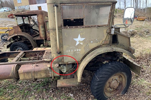

Old 18-05-20, 15:33
Posts: 14,970

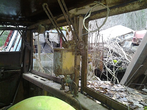

Some more parts of the winterzation kit on a pair of C60S in Sweden:
ID:	114149 Click image for larger version

Old 18-05-20, 17:10
Default MB-C2 Manual Online
Hi
Go to my website www.canadianmilitarypattern.com look down the home page and you will find one of the Cold Weather Equipment Manuals for Chevrolet CMPs. Posted in both pdf and jpg file formats.
http://canadianmilitarypattern.com/R...%20W%20001.jpg
Along with some other manual sections.
Old 18-05-20, 19:02
Join Date: Dec 2009
Location: Barrie, ON
Posts: 422
MB-C2W was also published as a complete manual where the supplement was bound together with a regular MB-C2.
The supplement is at the rear of the manual and the pages are exactly the same as the stand-alone supplement Phil has shared on his website.
Colin
