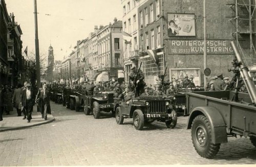

I agree, all I have read and seen seems to disclaim the use of Weapon Carrier by the Canadian Army in NW Europe at least.
But what about this picture? If you look closely you will see Dodge WC52's towing 1-ton trailers with mortars. The picture is captioned "Victory Parade of the 1st Canadian Division in Rotterdam, 10 June 1945".
Is this picture showing as captioned? Or did they switch it with a picture of a few years later and does it actually show a post-war Netherlands Army Parade?
Victory Parade of the 1st Canadian Division in Rotterdam, 10 June 1945.jpg   Victory Parade of the 1st Canadian Division in Rotterdam, 10 June 1945 - zoom in.jpg

Hello Hanno,
Indeed, strange...
Its seems to be American Dodge's and not Canadian...
I tried to enlarge the pictures to see some details but they became unclear.
Perhaps an exception?
Before the Canadian forces build their own wc's, they must have tried the American's. Maybe these are them??
greets

Old 15-07-10, 15:45
Originally Posted by Kenny Desaever View Post
Indeed, strange...
Hi Kenny,
Personally I think it is a post-war picture of a big Dutch Army parade, like the used to do back then, but I would like to be proved wrong!
Also see Info about Dodge WC 55 in British Service.
HTH,

hello Hanno,
Indeed, looking at the speakers and the fences along the road, it doesn't seems to be a '45 parade...
Actually, i would also be very, very happy to find a picture of an American wc 51, 52, 62 or 63 used by Canadian forces. But....NOTHING to find.....
I think it's more confincing to use an American wc than a (very late-war)Canadian one.
My belief that this is a post-war picture of a big Dutch Army parade, like they used to do back then, was strengthened when I received this picture today.
It shows the same Dodge Weapon Carrier trucks towing Dutch-built 1-ton trailers with mortars.

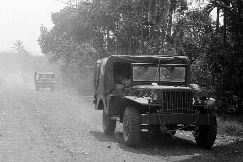

Originally Posted by Larry Hayward View Post
According to Bart Vanderveen, the Canadian Dodge Weapons Carrier (T236) was used mainly by other countries but only AFTER WW2.
Is this one?
In service with the Dutch Army in Indonesia, 1945-1949.

Hello Hanno
Nice pictures but there is so much wrong at this Dodge and the guys sitting on it but the right tire is Canadian .

Compare with this photo of a Dodge WC-51 in service with the Dutch Army in Indonesia:
