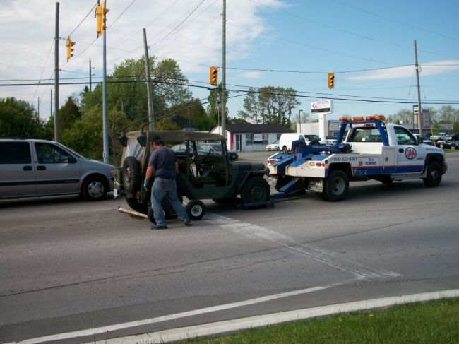

Went to the OMVA show in Oshawa today. It was a good shakeout run for me. Gave me a chance to put some miles on it and see if there were any kinks. Also got to see some other MUTTs in the flesh, as well as get a Club Membership:
I was having some Fuel problems which was causing some sputters every so often. I decided to pull the Carb while I was at the show to see if some junk got in the Idle Passage. It seemed to provide some entertainment to those who popped over. You have to love the simplicity of these things. Anyway, everything appeared nice and clean, so i'm suspecting the Fuel Pump is on its way out. I've noticed that the Fuel Filter (Clear Housing) doesn't seem to completely fill up while its running like it used to, so I may be starving the engine from time to time.
Now for the biggy. If you take the time to do a good job installing and maintaining your mechanicals, spring the $$$ to get the High Tensile Cotter Pins like the Tech Manual call for. Even though I went to great pains to make sure the Wheel Bearings were packed and pre-loaded properly, it was the cheapo Cotter Pins that left me in this position:
I'm not ashamed to admit when i've pulled a boner. Fortunately this happened while we were in town rolling at about 10km/h. Needless to say, i'm not sure when i'll convince my wife to come for a ride again.
Scotty

Closer inspection revealed that the Cotter Pin sheared and the Nut let go. Looks like the Nut loosened off a bit, then took the threads off, and well, you can see the result.
Needless to say, i've ordered the correct rated/grade Cotter Pins as specified in the TM. Time to put her up on stands again for a bit.
Oh, as for the sputtering... It was the plugged up Sock Filter in the Tank

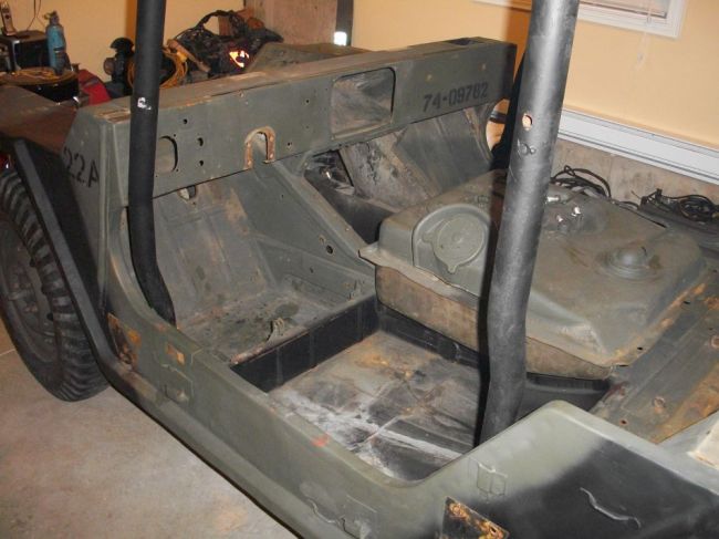

If you ever need a good workout, try removing ROPS Feet from the ROPS. What a colossal PITA!! I was lucky enough to have the complete ROPS and Feet out and easy to manage. I can't even imagine how hard this must have been with them still mounted in the vehicle.
They are finally off for the installation of the straighter "Un-Cut" ROPS.
Needless to say, I will be slathering the Feet sockets with Anti-Sieze when I reassemble.

So, a bit of background since this thread is spanning nearly 6 pages.
I built one good M151A2 from 2 x Demilled Units. Essentially, I used the Power Pack and components from one out of Gagetown, and the Body Tub from another from Calgary.
Mike McKinley was gracious enough to provide me with the Data Plate for the Gagetown unit (CFR 09782 from 403 OTS).
The other had no CFR or Serial Number provided. It did however have the original Odometer and TAC Markings which indicated it was C/S 9A from 1 Service Battalion. Scouring the paint did not reveal any other covered over markings. For all intents and purposes, it was a one VMO, one C/S Vehicle.
I spent a few hours on EDR Viewer, and was able to narrow down to a single M151A2 from 1 Service Battalion which had last maintenance entry mileage within a few hundred miles of where it is now. There was little evidence that it had been driven at all, since it was scrapped from the CF. Previous owner never had it running, and none of the others from 1 Service Battalion came within 5000 miles.
So, I think I may have found the origin of the Body Tub:
CFR 74-09195, Serial Number 43813
One last thing I was thinking of doing was comparing the Mod History of this CFR to the list of M151A2 CFTO Mods. I can visually verify if the Mods were done. Heres the hold up, I have the list of completed mods from EDR, but I don't actually know what the Mod Numbers mean.

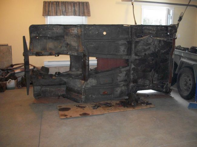

With the move to NB came some heated garage space and more spare time. So after getting settled in the fun begins......
The full restoration teardown has started. Its actually a bit more bare as of this afternoon. Only the front and rear suspension remain now to be pulled tomorrow. It is a real testament to the quality of metals used back in the day. Not only is there very little rust, but all of the bolts came out cleanly with nothing more than a simple wrench and ratchet set. No need to break out the Pipe and Cheater Bar.
Gotta love it when the previous owner used the garage as a home gym and put nice paint and blinds in
After alot of thought on sandblasting versus wirebrushing (on the grinder), i'm starting to lean towards wirebrushing. I tried the Heatgun and Scraper, but found it to be too time consuming. Rob Love, you were right, it does have 3 Color Cam under my Canadian Tire Cam. Wire brushing exposed some nice very clearly IRR OD next to IRR Flat Green..... So, back on topic, I'm assuming that if it is sandblasted, even though its stored in a heated garage (with the wifes dripping wet car), i'd imagine its going to need to be primed right away to avoid flash rusting. Since I can't actually do all of the body repairs right after the sandblasting, i'd end up having to re-expose a bunch of trouble spots. I'm liking the approach of just doing one panel at a time; strip, repair, light coat of rattlecan primer, then move on. Then when its completely finished, taking it in for a base coat.
Is Rattle Can primer going to be sufficient? Any suggestions on preferred brands?
Another thing i've been tossing around was building a Body Tub Rotissery. I can't find a way to build one without diverting a bunch of funds away from the project for metal and will most likely not require it after the restoration. Is there any harm in just setting the bare body on its side and properly brace it, turning it as required?
Scotty

hi scotty.i dont have a rotisserey either.i have 2 gpws on their ends right now.when i get my jeeps blasted i get them to shoot a coat of primer right away.regards jim.

Here it sits now... Completely stripped minus the rear Differential and rear portion of the Wiring Harness. Only one broken bolt on the whole thing, the mirror pivot bolt of all things. Between my Engine Crane and a few strapping buddies, I think it will be easy to just turn the carcass as required to get at the bottom. Your right Jim, a rotiserrie would be overkill. As it is now, I can lift up the front end myself.
I'm going to go at it section by section. Because i'm doing this all in my attached garage, i'm thinking about building a 2"x4" wood frame around it and close it in with Poly. Should keep the nasty dust contained. I suppose if the Ziebart in the nooks and crannys underneath proves a bitch to remove, I can use a small Pressure Pot Blaster.
Thanks for the tip on the Primer Don. I'll check it out at the local Napa. Sounds like it would be perfect for this. We hauled that MUTT down to the Swords last spring. I ended up yanking a few more parts from it, but the tub and suspension is still there.
Scotty

Well, its officially a frame off restoration now.. or whatever the hell you call a stripped unibody restoration.
I'm not the kind of guy to sit around and stare at it... So with an Engine Crane, some Shackles, Cargo Straps and some Sapper intuition, I managed to get it stood up on its side this morning over a cup of coffee.
This gave me a really good chance to really look over the bottom in a manner much more thorough than laying on a creeper with a flashlight.
Working my way up and down the uniframe with a body pick hammer it turns out (thank god) that the only rust through spot is right under the drivers side floorpan in a cross member. Not enough to even require a repair kit. I should be able to just cut the bad spot out and patch it with new metal.
The only other rust is just on the surface of the inside of the wheelwells from the usual road blasting.
Now the fun begins......
