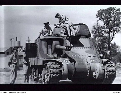

There are no unit signs so it could be either the 2/4 or the 13th tanks.
What about 2/8th tanks Gina? This unit served with 3rd Armd Div from Nov '42 through April '43, before relieving 2/6th in NG. Presumably they would have left their Grants behind...?
I believe these Grants seen at Homebush are in their original camo. Much the same pattern seen below in Jan '43. I wonder if 13 in the formation sign position is significant.
Name:	028519  SINGLETON, NSW, AUSTRALIA, 1943-01. GENERAL GRANT M3 MEDIUM TANK  3RD AUSTRALIAN ARMY TA.jpg

Only the war diaries could resolve that I think.
the 2/8 were detached from the 3rd early in 1943 so I wonder at the division insignia still on the vehicles.
The AWM say this
"In April 1943, after over 18 months of training, the 2/8th was sent to New Guinea, where it became part of New Guinea Force, to relieve the 2/6th Armoured Regiment. This was the 2/8th’s only operational deployment. Using M3 Stuart light and M3 Grant medium tanks, the 2/8th’s main role was to defend Allied airfields against possible attack by Japanese paratroopers. The regiment was headquartered at Port Moresby, where it also had one of its tank squadrons, while the other squadron’s were at Milne Bay and Buna. The regiment also carried out joint training exercises to improve tank and infantry co-operation in jungle warfare. The regiment returned to Australia in February 1944."
If only one squadron was a Moresby then at least one squadron of Grants would have been deployed to Milne .....I would like to see a photo of that !! ( three squadrons A B and C one of Stuarts two of Grants.)
Wiki says: From 15 November 1942 the 2nd Armoured Brigade and the 2/8th Armoured Regiment formed part of the 3rd Armoured Division.[3] The regiment was separated from its brigade in April 1943 and deployed to New Guinea where it took over the 2/6th Armoured Regiment's tanks.[4] The regiment's role was confined to infantry co-operation training and static defence of major Australian bases. As a result it did not see any action. Squadrons were stationed at Port Moresby, Milne Bay and Buna.[2][3] Which Makes more sense and discounts those on the Train at Homebush being 2/8
There are no photos of them in PNG in Grants ands Stuarts I can find it is also inconsistent with the story I have been told that Grants and Stuarts were not deployed overseas post Buna. The Wiki article makes more sense than the AWM one.
So Tony if they were posted with Grants and Stuarts then Maybe but if not the insignia is consistent with the 13th tanks returning post disbandment.

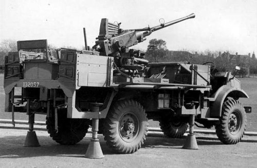

For paint application the gun tractor pics you're referring to Gina were sprayed with the disruptive pattern while in-field efforts were often with a brush and rough as guts as you've seen on your Stuart.

I agree keith all of the vehicles I have seen ex factory are sprayed as were those ex the large Army overhaul units.

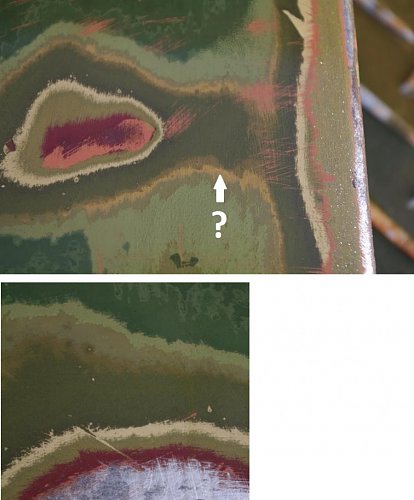

I’ve been playing around with this some more with 600 grit wet and dry. I didn’t have anything finer here so thought I would try that.
These photos were taken of the surface I’ve been working on, with the surface wet. I’ve taken some close-up photos as well and apologies; some aren’t that great. The armour feels reasonably smooth but the paint itself (all coats) strikes me as really thin.
The two areas I am examining are on the panel between the rear wheel and the commander’s door. According to every period scout car photo I’ve seen the two areas should show the contrast in the disruptive pattern. That is, one spot should be the khaki green, the other the light earth/light stone.
To add to my confusion however, I am seeing this reddish brown paint in both areas. I would describe as almost being clay-like in colour.
It doesn’t look like a primer to my untrained eye but I could be wrong. There are some spots where you can clearly see the darker green (post war?) so I am wondering if a lot of that was stripped back at some stage judging by the pieces that are left. That might explain why the paint appears very thin.
You can also see some darker areas again which are the rust spots.
I will persevere with this and I probably need to continue over a wider area to see if I can identify the places in the disruptive pattern (if there is one there) where the different colours meet.
At this stage I have a few theories:
* The reddish brown paint I am seeing is the original primer (bugger!)
* The reddish brown paint I am seeing is the light earth (Could it be? It doesn’t look like the light stone to me) and the vehicle was painted with that colour first and then the khaki green went over the top
* I have completely got the pattern wrong from photos and will need to sample another area

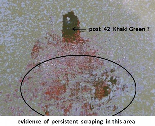

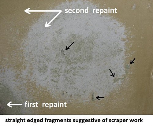

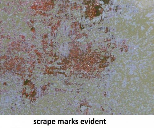

That's my conclusion too Darryl. The impression I get from your photos is a panel which has been stripped back to bare metal using paint stripper, with stubborn areas attacked with a paint scraper leaving the odd fragment here and there. I suspect these fragments are the only original paint we're seeing, and if you work very carefully on them you may find other paint layers underneath, including primer.
Having been stripped back to bare metal it appears to have been repainted without primer, causing extensive rust formation due to extremely thin coat of porous matt paint. I agree the reddish colour does not look like primer, and it's also contiguous with the darker rust patches. Rust forms a variety of compounds in a range of colours depending on oxygen concentration and the presence of other elements, including chemicals in paint stripper if not washed off immediately and thoroughly. I think rust is a more likely interpretation of this colour than red primer, and the proof will be change in colour now that it's fully exposed to air and moisture.
At some later stage the vehicle appears to have undergone a second repaint consisting of grey primer followed by olive drab of some kind.
If the vehicle has indeed been stripped back to bare metal as I suspect, then the key to identifying original paintwork lies entirely in the tiny surviving fragments. That's where I'd start looking myself, and provided there are enough of them sufficiently dispersed it should be possible to confirm camo if present. I'd also give serious thought to Mike's suggested technique in this case, as it requires only the tiniest fragment to provide full paint history. The difficulty of course will be chipping it off the granular armour plate surface, which I expect would provide far greater adhesion than sheet metal. It may be worth trying to soften with paint stripper first, allowing it plenty time to penetrate. Whatever technique is employed it's clear that a forensic approach is required here.

Evidence suggests Light Earth was introduced in production for armoured vehicles only, and where seen on softskins it has been applied in the field.
I should qualify that statement in respect of softskin tactical vehicles, for which evidence of Light Earth in production most definitely exists.

The more I have looked at it, the more I see bare metal in the right light around that reddish colour, and I think you are right. It is rust on the surface.
I cleaned back the paint on another part of the body (the area in front of the windshield) which should be completely original to this vehicle (that is, not an armoured panel that could have been added post-war) where the disruptive would have been on an AOP. Again, the same pattern of green and that primer, along with the red colour (rust) below as what I had found on the other areas.
It is interesting as I had located the white US star further back on the side panels, and always assumed they were original. However, I sanded through the white paint on the star today and it revealed the same pattern of paint that I had seen in the other areas, albeit without the reddish rust colour. There were some areas of darker rust right underneath it though where I rubbed it back.
There was no sign of any original US paint under it, nor any primer and I think the stars and probably the numbers in white paint I’ve found on the hood were added in at some stage previously when the whole vehicle was stripped of its paint.
Gina – hope you didn’t think I was taking over your thread. I thought this might have helped to ‘paint’ the picture on the disruptive paint aspect but alas it looks like this scout car cannot contribute anymore unless I get some paint chips off like you say Tony!
