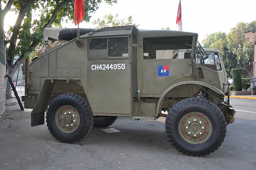

  #69
Old 13-10-09, 21:41
Walde Libera Walde Libera is offline
Location: Coquitlam, British Columbia, Canada
Posts: 95
Default CGT- BC 2009 Tour
I few shots of the tour. Our tour was extensive, Merritt was our first stop. Then on to Logan Lake, that's where the heavy equipment is. Unfortunately while driving the FAT out of Chase I lost oil pressure and promptly stopped or better stated the engine came to a grinding halt. So the rest of the trip the FAT stayed on the trailer. The last shot is I'm inspecting the bottom end of the 235, #2 rod bearing spun.Still repairable though! I was revving the engine a little high, as I was told by a M135 following at 55 MPH I was leaving trailing behind! So they nickname for the FAT became "Ferrari". So what's the math for 55 MPH with 7.17:1 diffs and 11.00X20 tires? What was the engine RPM?
Walde

Old 13-05-20, 10:22
Default BC CGT in CA
“Toadman’s Tank Pictures” spotted Walde’s CGT on display at the 2016 MVPA National Convention in Pleasanton, California, USA.
It sure does get around.
