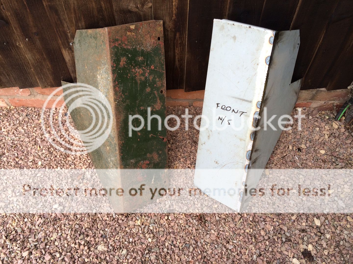

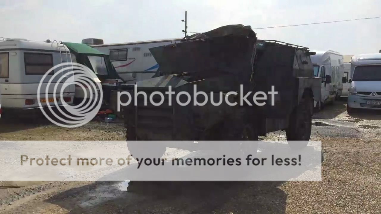

As can be seen the front wings/ lockers are badly perished and the rear off side locker/ locker arrangement is of a similar end.
I would imagine the hardest part will be the front lockers/ arrangements to replicate?
