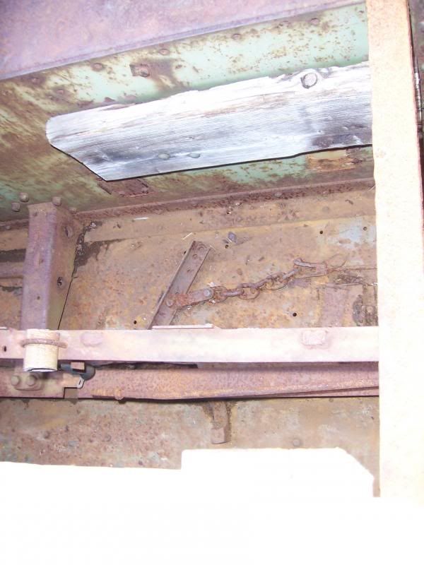

Is this piece of wood supposed to be there? I think the chain is the only part of the brake steering i have, the other chain and the rest of the linkage to the steering collum is missing. Also is the small piece of tube fastened to the rail original?

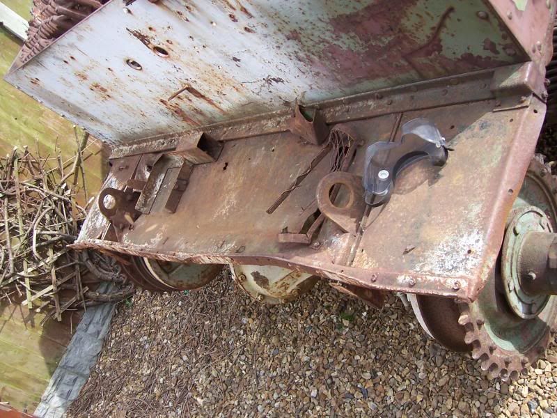

What is suposed to be on this panel? I've got the remains of something?

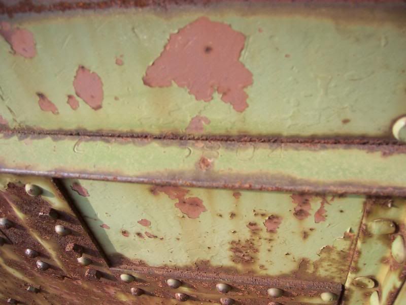

Found another number on the back. and cb 5804 on the front.

Is the red primmer you can see all over the carrier the normal colour used from the factory? The green it's painted with has been done after it was cut, so i'm wondering if the original paint is between the green and the red, and maybe the number is still there, where were the numbers painted when they were originaly done?

The rear plate, the angle bit which is made into a square is for the bottle Jack and it's wooden footing plate... There are no chains used in the steering system however I can see the end of a clevis from a steering linkage bolted to the end of it.
DO NOT THROW ANYTHING OUT !
it may prove useful later
Mine was painted in red oxide like yours, as was Gordon's (his carrier being two away from mine) both our carriers are 42'ers
The tube holds the cable from the smoke discharger when it's mounted in situ... It's basically a bike brake handle and a cable....roughly translated !

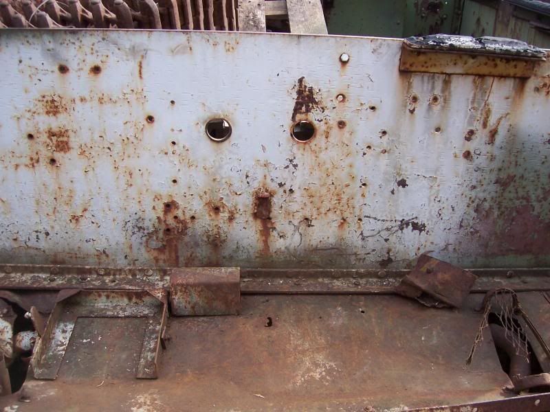

At the rear, there are two similar boxed steel things. the mangled one with the stud is the same size as the good one, except the top is open. They hold the jack handle. A strap is fixed to the opposite side to the stud, and comes down onto the stud to hold the two extention halves and the handle in.
The fitting at the right locates the business end of the crank handle.
Bolted to the rear upper plate, above the jack handle is the big armoured battery box (two rows of 3/8 bolt holes) This has the POL box bolted to the back of it, which in turn has the number plate board (steel) This has the tail light mounted on it.

John, you wrote:
Is this piece of wood supposed to be there? I think the chain is the only part of the brake steering i have, the other chain and the rest of the linkage to the steering column is missing. Also is the small piece of tube fastened to the rail original?
Toss the wood in the skip. You will eventually need a rear seat bearing plate CTL 13116 in there to support a seat frame above the fuel tank mounting brackets. There is a corresponding similar length bearing plate TL 13115 mounted to the engine cover frame to support the opposite side of the seat frame assembly. You can toss the chain, it is not a brake part. The angle iron attached to the chain can go out too. As Richie mentioned, there are two steering clevis parts, one on either end of the chain. One appears to be CTL 4051, the other CTL 1737. Toss the pipe on the engine rail, as well as the clamp holding it in place.

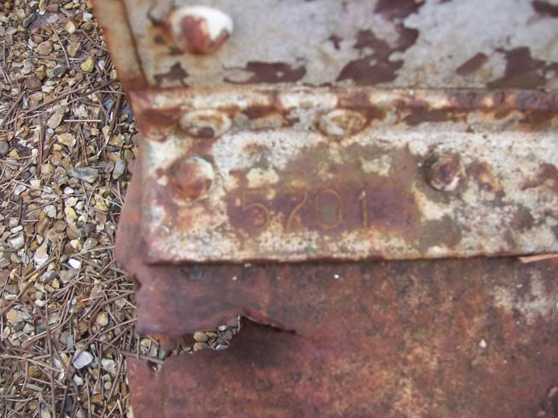

Does your lower hull number 5701 have a upper case letter 'C' with a line through it?
Your MK-I*carrier was built about the end of April, or very early May, 1942 at the Ford plant, Windsor, Ontario, Canada.
5701 C question.jpg   5746.jpg   Rear seat bearer 13115 and 13116.jpg   JRippo rear seat bearer 3 and 4.jpg

thanks again for your help. Here's a picture of the numer on the front.
Old 31-03-14, 14:05
Michael R, is that his "T" number? What is the "CB"?
If that is the T number she is a fairly early U.C.

Hello,
Had a look tonight, can't see a c on the rear number?
John

my mk1* has the lower hull number in the same place as john's

I can see a mark at 8 o clock from the rivet, but without some wet and dry, and the ability to climb through the monitor, i cannot help any further

I'm 20 miles from the carrier telling my brother where to rub. I can see the mark you mean and i have spoken to my brother again and he says there is nothing there. I'll give it a good wire brushing at the weekend to be sure. Will come up and see you soon as i get a bit of time.

Old 01-04-14, 07:30
C8AX Ambulance (NZ), UC1*
Join Date: Aug 2006
Posts: 388
Default The CB number (upper hull number?)
Is that on the angle above and behind the gunners seat?
Rob
Old 01-04-14, 08:21
Join Date: Dec 2011
Location: Stockport
Posts: 149
Yes the CB number is from behind the gunner.
