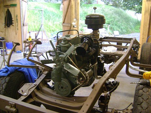

Well its been some time but I thought I would give you an update. Firstly thanks to Hanno for posting the last picture. I have finished most of the fabrication so here goes. The rear mud guards and inner mud guards were made using a wooden former. I cut, heated, hammered and welded the steel sheet, its not perfect but its not bad.

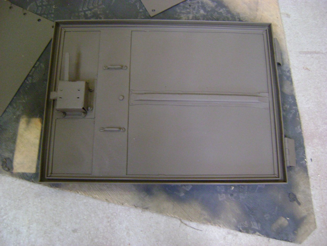

The Three rear doors, hinges and latches are all made and awaiting painting. I was going to buy original door mechanisms from Dirk at LWD parts but as the doors aren't original, I decided to make my own. They are not exactly the same, the springs are different but once they are inside the door you cant tell.

So the chassis is complete and ready to go into another building while I prepare and spray the body ready for the two to be mated back together.

More pictures
