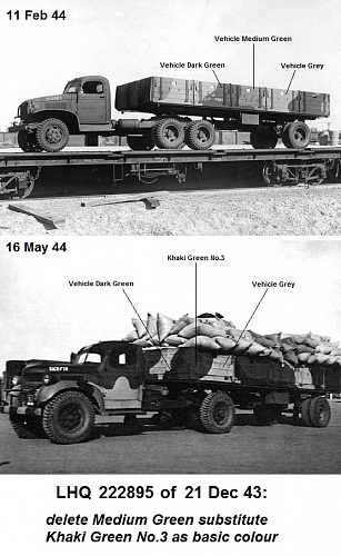

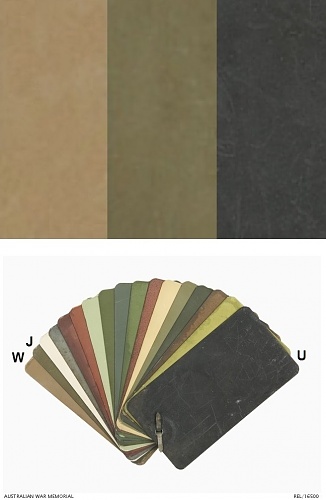

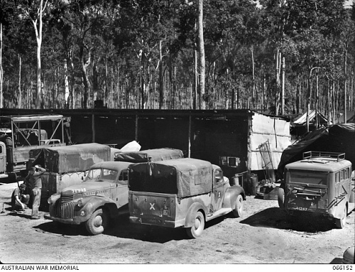

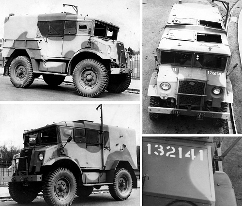

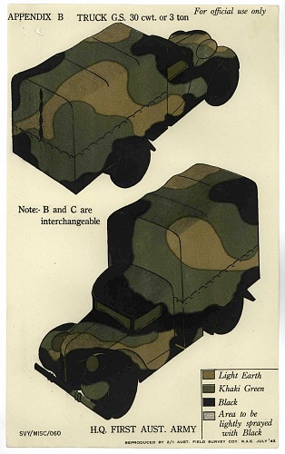

This photo shows First Army scheme in May 44 which means the paintwork is about 18 months old. I don’t have the pattern chart for Vans but it’s easily recognizable from the Truck chart. Rather attractive scheme I reckon and probably quite effective in the terrain seen here, although I suspect Light Grey would serve well too, judging by the grey gums visible in the background. Notice again the closeness in tone between KG3 and Light Earth, almost indistinguishable in B&W photos, nothing at all like ARN 132141 scheme.
Name:	066152  WONGABEL AREA, QLD. 1944-05-05.  110TH BRIGADE WORKSHOP, AEME  3-tone camo First Army sc.JPG
Name:	3  First Army Pattern Chart a.jpg
Name:	066152 detail.jpg
Name:	First Aust Army  W-J-U.JPG
Name:	FGT9  ARN 132141.jpg
  #482
Old 05-11-17, 22:23
Lang Lang is offline
Location: Brisbane Australia
Posts: 1,690

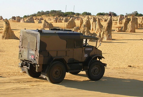

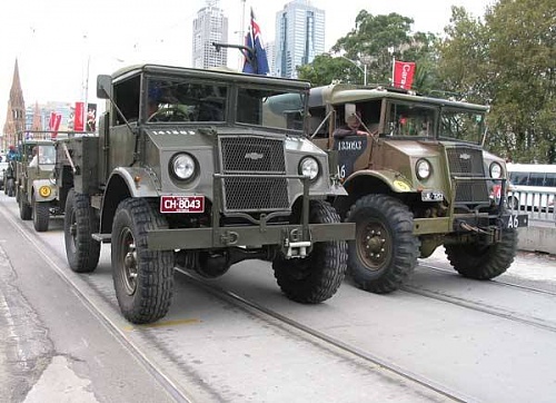

Interestingly Tony that is starting o get close to the current colours.
Lang
  #483
Old 06-11-17, 06:37
Tony Wheeler's Avatar
Join Date: May 2012
Location: Yarra Junction VIC
Posts: 953

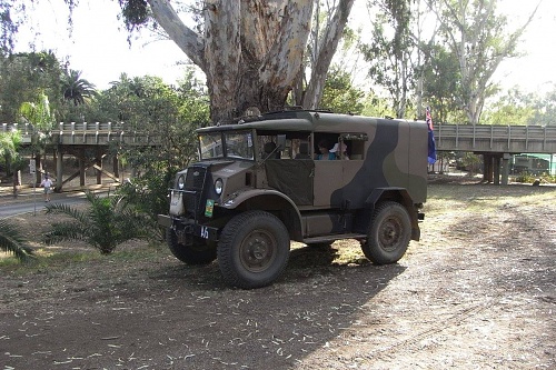

Colours are very close indeed Lang, here are the modern colours on Euan's gun tractor. This could pass as 1942 First Army scheme.

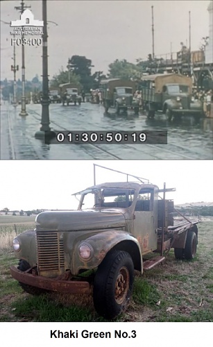

Just looking at the photos of the sale Landrovers.
The three vehicles are photographed on the same spot beside the building. All three are entirely different colours owing to the camera settings. This is with modern digital technology.
Shows how impossible it is to match colours from WW2 colour photography not only because of lesser technology but age and copying losses or changes. Best you can do is an indication of pattern and hope that what you see is close enough to a known colour to bet on its name.
Lang
  #489
Old 08-11-17, 04:42
Exactly, Lang. I had chosen those 3 pics just for that reason. Not only camera settings and photo reproduction (in those days, or computer monitors these days), but ambient lighting. Indoor/outdoor, bright sun or overcast.
Makes it very difficult, if not impossible to definitively define a colour by photo.

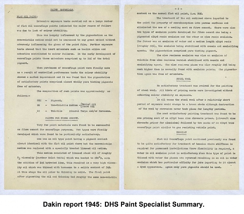

Originally Posted by John Ward View Post
Does that mean there was a shortage of gas-resisting KGJ paint in ~Jan 1943?
Because if I remember correctly, gas-resisting KGJ was already issued in MC319 Jul 1942 (before that it was still non gas-resisting, i.e. MC301 Jan 1942).

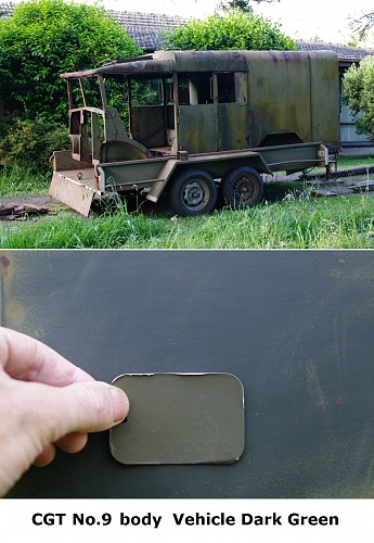

John, your question suggests you may have misconstrued Army paint vocab which changed in 1942 when DHS paints including KG-J were introduced. Prior to 1942 there was only ONE paint approved for use in Australia, that being Khaki Green No.3 which was gas resistant under military specification M.G.O./AUST. 101A. During 1942 however, the introduction of DHS Camouflage Paints produced under S.A.A. Emergency specifications (E) K 506-508, which made no provision for gas resisting paint, gave rise to the need when ordering paint in the field to specify two things:
1. Paint Colour required (A.S.C. letter code).
2. Paint Type required (gas resisting / non gas resisting).
Obviously the term “Khaki Green No.3” does not enter into this equation. It is denoted by Paint Colour: A.S.C. “J” and Paint Type: “gas resisting”. Hence the language used in MC319:
The basic colour of vehicles for use in Australia is Khaki Green A.S.C. “J”, gas resisting, and the disruptive colour is to be Light Earth A.S.C. “W”.
Subsequently in 1943 when DHS Camouflage Paints were replaced by Army Camouflage Paints (“Vehicle” colours) the paint vocab reverted to pre-42 usage: “Khaki Green No.3”.
75 years later, as restorers and modellers, we need concern ourselves only with “Khaki Green No.3” because THAT was Australian Army Service Colour from 1940 to 1949, and THAT was the high tech gas resisting alkyd enamel paint, and THAT was the paint used in vehicle production. The term “Khaki Green J” refers to DHS Camouflage Paint, which was cheap and nasty Flat Oil Paint produced to lowest cost under Emergency specifications which even Dakin himself declared useless:
Copies of the original Australian paint specifications are appended. They proved almost useless in practice. A revision of the Flat Oil Paint specification made in February 1943 should indicate the difficulties of achieving satisfactory results under the first specifications.
It should always be remembered that DHS Paints were NOT automotive paints and were NEVER intended for use on vehicles. I’ve attached some documents to help illustrate this point. Also a photo of Matt Austin’s K5 Inter showing 75 year old KG3 paint colour revived with nothing but a wet rag, demonstrating the remarkable durability of ARMY SPEC paint in stark contrast to the abject failure of DHS SPEC paint such as KG-J.
It’s a great shame Gina tried to promote “Khaki J” in this thread and spread so much disinformation for 3 years. I’m hoping we can get beyond that and start exploring Army Standard Colours which have been neglected for so long.

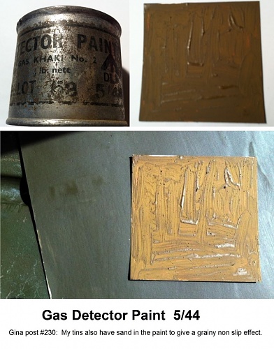

Old 10-11-17, 02:57
Join Date: May 2012
Posts: 953

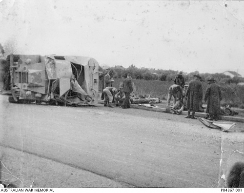

Gina posted some pics of this stuff a while back, apparently it's gritty finish. Evidently it was painted on the bonnet, not visible in photographs when vehicle upright.
Name:	Gas Detector paint (Medium).jpg
Name:	P04367.001  c. 1943-44  Cab 12 FAT attached to 108th Tank Attack Regiment lies on its side after.JPG

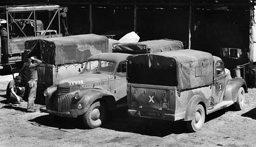

  #496
Old 10-11-17, 03:57
Posts: 2,402
Note the way the camouflage paints on the Matador at MEE Monegeeta vary with the light intensity - the disruptive colour across the front is much 'whiter' than the sides, yet it is the same colour (whatever that may be). Same with the wheels - front to back are both the same colour, but look different in this image.
This simply reinforces what has been said previously in this thread: that trying to interpret camouflage colours from a monochrome image is just about impossible. There are too many variables in terms of light/shade and how the image was processed.
And if we could see the last figure of the Embarkation/Unit serial number on the windscreen of the truck on its way to Normandy, we would know exactly which unit it belonged to ...'2239X' - there are nine choices (22391 to 22399 - 22390 was not issued)
I’m not sure what you’re getting at here Mike. I mean, it seems like a statement of the obvious to me. Objects vary in appearance according to the light intensity falling upon them. Like, the dark side of the moon, and the light side of the moon. You wouldn’t compare objects in bright daylight to objects in the shade. You can only compare objects in the same light. Which is to say, the same plane of light. I mean, that’s obvious, isn’t it? In practice that means flat panels with disruptive pattern across them, so the adjacent colours can be compared under the same lighting conditions. Hence in the Matador example you’d probably choose the driver’s door, because the frontal area is way overexposed. That is, the film has been pushed beyond its ability to register tones, it’s just plain white.
I think we may be talking at cross purposes here. We’re not trying to identify colours in isolation, based on visual appearance only, we’re trying to identify the camo scheme, from a limited number of possibilities, which then tells us the camo colours. We have a lot of information about camo schemes, including date of approval, prescribed patterns, which we bring to bear on the problem. This gets much simpler after 42, because there are so few colours to choose from. Eventually in 44 the problem solves itself, because there are only 3 vehicle paints scheduled, and a 3-tone camo scheme.
Armed with this kind of information we can start to make fine distinctions, like the two semi-trailers pictured. Notice how the scheme as originally intended displays even separation of Light Tone / Medium Tone / Dark Tone, but with KG3 substituted it becomes virtually 2-tone scheme, because KG3 and Vehicle Dark Green are much closer in tone. Indeed, dare I say it, “These colours are useless for disruption as they are much too close in tone and merge at a very short distance.”
Name:	LHQ 222895.jpg

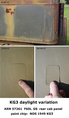

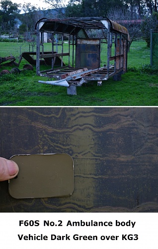

This is something we can view in real life. Pics below show 1949 KG3 paint chip confirmed against 42 KG3 paintwork, which as you can see varies so much in daylight as to generate 3-tone scheme from the one colour! Notice how the 49 paint chip follows it faithfully, which may not be possible with modern pigments.
Name:	NOS 1949 KG3 ex-Keith (purchased Hughes Trading mid-70's).jpg
Name:	KG3 daylight variation.jpg
Following pics show KG3 reference chip against Vehicle Dark Green, firstly on the ambo where it appears over KG3, and secondly on the gun tractor over red oxide primer (not seen in this photo) which came as a surprise because I had always assumed it was KG3.
Name:	No.2 Ambulance body.JPG
I’ve come to believe there was a lot more Vehicle Dark Green used in late production than I realized, and I’ve found quite a few examples already. I’m even learning to recognize the faded colour, which is slightly different from faded KG3. You’d be surprised how quickly your eye becomes trained if you do enough of this work on colours. Plus it adds another level of interest when clambering over blitz wrecks, armed with 400 wet & dry, large bottle of water, KG3 paint chip and camera!

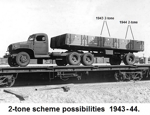

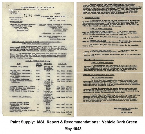

Now that we’re acquainted with Vehicle Dark Green we can take another look at Staff Cars and Vans, where 2-tone scheme features widely in 43-44 (examples seen below in NG, QLD, NSW, VIC, WA).
Firstly as Mike Kelly observed in post #453 concerning example 1: “The darker disruptive colour has a noticeable shine to it . Hmm”
Paint quality suffered during 1943 owing to shortage of phthalic anhydride, which led to suspension of gas resistance spec for a period, as well as various other concessions being made for suppliers. For example, B.A.L.M. tender for Vehicle Dark Green supplied ex-Melbourne against Contract Board Schedule T.71308 of March 43: “It is recommended that the tender of B.A.L.M. Pty. Ltd., Melbourne, be accepted for immediate requirements under concession of non-compliance with para. 69 – Mattness, of the specification.”
So, Mike, not only can we identify the colour, but even the likely brand of paint!
But what of the other colour(s) seen on these vehicles? We already know Vehicle Medium Green was discontinued in late 43 which leaves only one possibility in 44, namely Vehicle Grey. This may explain examples 9 & 10 which appear to display more tonal separation (higher contrast) than earlier examples painted when Vehicle Medium Green was still available. The two possible colour combinations can be compared side by side on the 7-ton semi-trailer body. Further guide to colour can be had by comparison with uniforms in some photos.
Note that KG3 can be ruled out due to closeness in tone with Vehicle Dark Green as shown in posts #505 and #506. Any vehicle painted in these two colours would appear extremely dark indeed.
