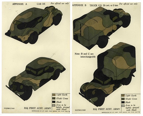

Thanks Jacques that is really helpful.
I was thinking of doing the Stuart in straight olive drab and the blitz in camo.
I will need the camo colours for the blitz sometime this year .

There's a good series of books by Mike Starmer that cover wartime British colour schemes - would the same colours have been used by all Commonwealth countries?
The books cover the camo scheme for each theatre/period, and have paint chips in the back to colour match.
Old 20-03-13, 02:37
Posts: 2,390

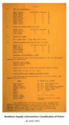

No: the paint colours used by Australia were unique. They are the Australian Standard Colour (ASC) and each was followed by a letter indicator. They are similar to the BSC colours that Mike S has studied and that are included in his books, but not the same.
The colour chart booklets were produced by the Standards Association of Australia. Surviving examples, especially in good condition, are rare to say the least.

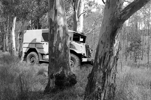

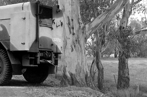

I've been meaning to ask your advice Tony - what are the relative merits of two-pack vs. enamel with hardener? I'm considering Light Stone matt camo so durability/stain resistance is a major issue. Light Stone is very pale and will no doubt pick up a lot of road grime, so it will need to stand up to regular washing. I never wash my white car but a FGT is a different matter!
