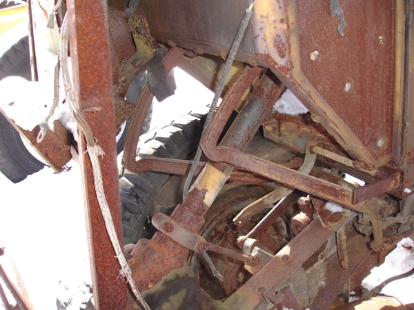

Photo 1/6 - rod to pedal has possibly been modified, it looks a bit odd as well as bent.
