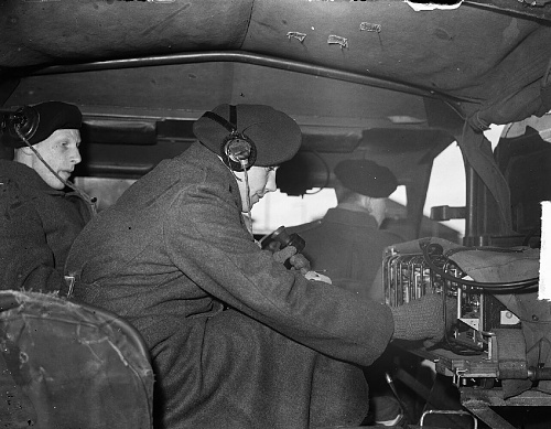

Here is a photo of a C15TA with two 19 Sets mounted.

Hi Hanno
Yes thanks, I have seen those other threads. Here are a couple of photos showing two chore horses mounted on the rear wall in lieu of the POW cans.
I assume the two 19 sets would be, as Chris states, power hungry. These photos given to me by Brian Gough.
Barry

Aerial storage on rear below doors.
Name:	19 Radio Mounting-1.jpg
