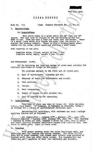

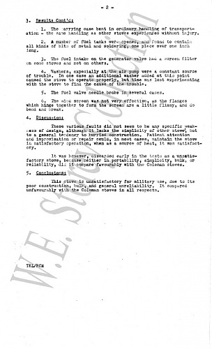

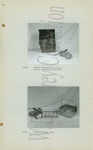

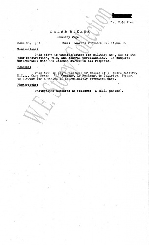

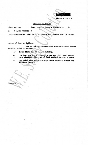

Colin, that is a thorough piece of research on the Cookers, Portable, No. 2 and thank you for posting it. Here is a report that was written on the Cooker, Portable Mk II, No.2 following a cold weather test that was conducted in Canada in 1944.

Thanks for your comments and for posting the report.
The report seems to help confirm that the British Cooker was not the type that was in common use in Canada at the time.
