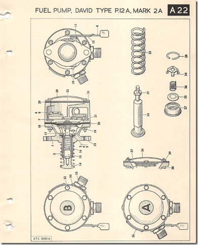

John,
Congratulations on getting the old girl running!
Sounds like the fuel pump you were using to prime is a bit dodgy. If it gets worse, check out the fit/gap between the check valves and the pump housing. I removed the check valves and messed around lapping the disk 25 onto the seat 27 to no avail. I could only get about 2" Hg vacuum to pull fuel. Then I realized the valve could leak between the seat 27 and the fuel pump body since there is no gasket. I'm used to seeing a gasket here on other vehicles. Using some Aviation Gasket goop to glue the seat to the body increased the suck to 5" Hg, a big improvement. Hope it lasts.
Malcolm

Hi Malcolm, Rick
yes sir, I think we could benefit from a pair of new pumps or a rebuild, I remember on my FV432 that the fuel crossover/drain also had only one gasket where I felt it needed two...
Rick I will PM you on the parts, thank you
I am going to get the old girl in the shop at the end of the month for some interior work so pumps over the winter I think
John
