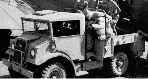

Any thoughts about the cargo body? Meanwhile Robert Sexton has had Drawings for No1 Australian body made up.
May I suggest you try to recreate the Australian No 1 GS Body? That is the composite body (angle iron/wooden planks) as pictured by David

Is that a left hand drive C15 ? My first thought was that the photo is back to front but most cargo planes have the loading door on the left side as in the photo.

Old 29-08-18, 18:27
Default Could the plane be a civilian DC3
Hi David that is very good spotting on the hatch being on the wrong side, one thought is could the plane be a Civilian DC-3 some of which had doors on the other or right side of the aircraft.

As I understand it, most 13 cab C15s have the spare wheel on the left side as in the photo. I think that some Indian bodied ones have it on the right but that is an Australian body isn't it ? The one in the picture not only has the hatch on the right but I think it is possible to make out the steering wheel on the left. If anyone had a clearer version of the photo it should be possible to tell by the Chevrolet badge as this is not siametrical.

Default Chevrolet emblem
https://media.gm.com/
https://media.gm.com/media/us/en/gm/...02_bowtie.html
It would appear that the photo is reversed.
  #119
Old 30-08-18, 00:07
Well spotted, the photo is indeed mirrored!
The aircraft door had me puzzled as it seems to be a Dakota, which has a cargo door on the left hand side (the military C-47, that is).
But if you look closely it looks like the smaller passenger door which was fitted to the right hand side on some civilian DC-3’s.
  #120
Old 30-08-18, 00:34
Default Here you go
Even the ARN reads better now.
