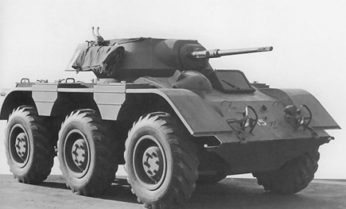

That is what springs to mind, indeed: T28/M38 Wolfhound 6x6 Armored Car.

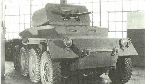

There's also the 'Wolf' 8x8 heavy armoured car, which was a Canadian development - but it was an 8x8, and only one was built.
Wolf: WFVCanada2HAUGH.pdf

Based on the Wolf being a Ford development, it seems unlikely that it would have used the same engine bearings as a GM 270 engine (but anything is possible.
