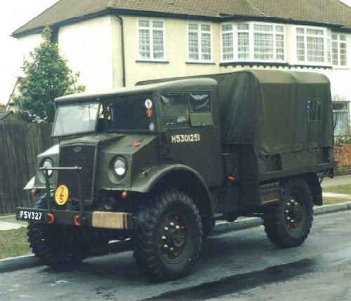

The one fitted to the lower left hand corner of the cargo body, you mean?
Interesting, but I have no clue either. Could it have come from a British truck?

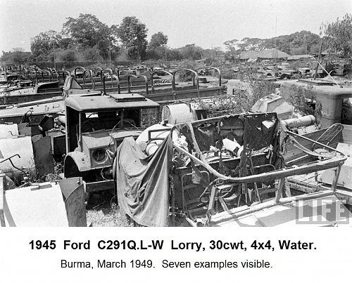

As per my Facebook post the CMP type pictured is C291Q.L-W Lorry, 30cwt, 4x4, Water. Here’s my general take on this type with known images.

Name:	C291Q.L-W  Chowringee Road, Maidan Park, Calcutta 1945.jpg
Hello Tony,
Yes, we need to do some more research on Ford's 1945 C291Q models. I think we should go back and study:
1) available source documentation to get a clear listing of contracts and corresponding vehicle configurations;
2) a field survey of known surviving examples;
3) "counting heads" or the ongoing study of period photographs (as you have done above).
Due to the limited nature of available reference sources, there is a risk of "educated guesswork". If we have made any assumptions, we should make note of them.
In this case it, is vital to state that the designation "1945 C291Q.L-W Lorry, 30cwt, 4x4, Water" you have labelled the above photos with, is your own interpretation of what "C291Q.L-W" stands for.
