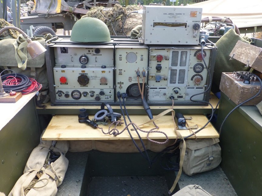

Canadian WS9 in the back of my White Scout Car...
Need to find the correct power plug - anyone have one please?
Tim

Tim, what a great pic of your set. It's fantastic seeing them installed and in their element. Well done.

another superb offering for us to drool over Bruce and yes, brilliant seeing Tims' one installed.

Yup- That's the Plug/Cable am looking for... happy to consider a repro if you make some.
Reasonably happy with the set installation - need to make brackets for the batteries sometime and fit them - and adjust the antenna mount.
Tim
