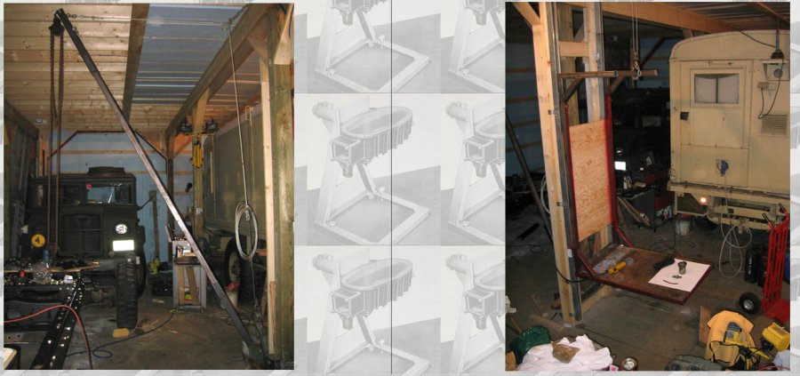

Hello All,
Earlier this year someone posted up a couple of photographs of a hoist they had made to lift heavy objects from the ground up onto a mezzanine level in their shed.
I meant to copy the link down and ask the person about it. That was a while ago and where I thought the link was posted turned out to be incorrect. To jog people's memory I recall the photograph was accompanied by one of an engine lift mounted on a horizontal pivot, that was attached to a steel shed post.
Could the person who posted the photographs, or anyone who knows the post please step forward? It would be great if the Permalink to the posting could be copied into the reply too Thank you in advance.
Kind Regards
Lionel

Hi Lionel
Is this the one you are thinking of ?
Name:	Screen Shot 2016-05-16 at 10.02.09 AM.jpg
Little more information on my web page http://canadianmilitarypattern.com/Tools.html
If so this is the lift I built for my barn back in 2003. Based on electric hoist, with barn door track for the guide rails, 2x2inch box tubing frame.
Makes moving things up and down stairs to the loft of the barn much easier and make the loft really usable for active projects. Will lift 1200LBS easily platform big enough for one of my engine test stands with engine.
One of its more more day to day uses though is as a adjustable work bench in the shop, great for getting stuff to right height for working comfortably. Great for small parts like whole CMP axle assemblies.
It has a insulated shaft cover that is picked up as the lift cage reaches the loft. Covers the hole so you don't fall through and keeps the heat in the shop during the winter.
If anybody has questions ask away.

G'day Phil,
Yes that is it!
Thank you very much for taking time to find the post and replying.
I will copy the link and store it away this time. Questions to follow.
