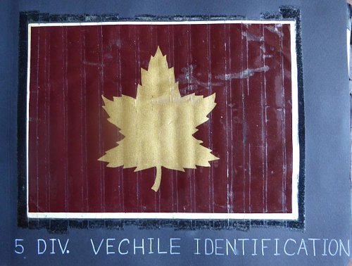

I have this original WW2 vintage 5th Armoured Div symbol vehicle transfer in my collection... stuck in the pages of an album from a veteran's estate.
Is there any benefit from investigating reproductions of this?

I had some made up for my carrier from pictures, and I would say having an original would definitely make it easier.

Tim
Might I suggest a 1:1 template? Even if it is just a photocopy or simple outline drawing or mylar stencil.
Thse were the same size and shape for the various divisions with the exception of the background colour.
I used a photo copy from Barry Beldam's book to do the paint work on my 12 cab years ago...
Nothing makes me crazier than a maple leaf that looks like everything other than a maple leaf. eg a pine tree or cartoon drawing of same...

I will ask a friend who works in graphic design to see if he can copy this... he should be able to reproduce it to make it look exactly as the original.
For other divisions, will change the background colour in accordance with below:

Colours fade when exposed to glue and paper. When you photograph it, try to get a Red Green Blue White Black colour sample card in the shot. A skilled Photoshop worker can use the examples to match up the decal with its correct colours. But it is really hard to properly freehand the details like the points on a maple leaf.

Nice find Tim; great to see an original water slide decal.
Colin's website has some more info on this subject:
http://bcoy1cpb.pacdat.net/markings_...y_vehicles.htm
I can't agree with that Terry. It shouldn't take a skilled graphic designer more than half an hour to make the complete artwork, including tracing the maple leaf either by hand or with use of a live-trace function.
Tim, let me know if you have any luck at your end, otherwise I can do it for you.
If your next step is printing a decal or sticker, than use a Pantone K5 fan-deck directly to the original decal. The number can than be used in the Illustrator or Coreldraw file for the correct colour (that doesn't take fading into account though), or communicated with the print-shop directly.

Will do - the cloth patches have been folded away in an album most of their lives... so shouldnt have faded too much... but we will refer to other sources too.
If anyone has the RAL paint number then that would be excellent.
