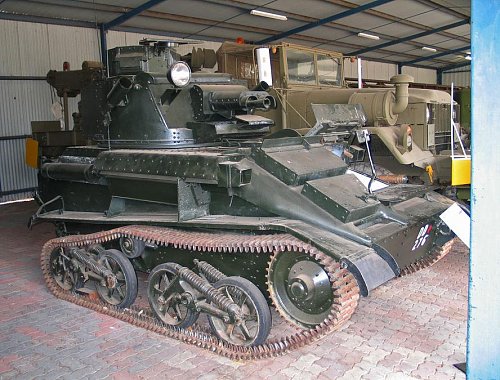

Joining the dots from the bits and pieces I have found on the vehicle this is my current mud map .
The sand guards are purely speculative as they were not on the Tank when it was auctioned off after the war.

Two-Tone

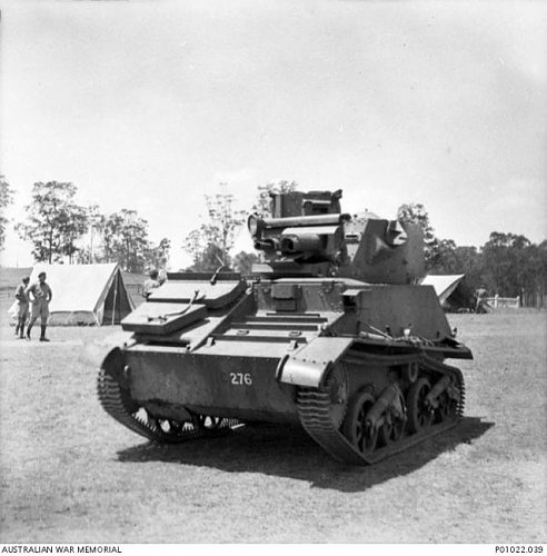

  #76
Old 25-08-14, 18:03
Tony Wheeler's Avatar
Join Date: May 2012
Location: Yarra Junction VIC
Posts: 953

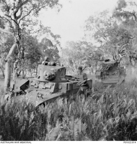

Originally Posted by Gina Vampire View Post
It looks just like the Light Stone on your door Tony . Same Same with Pictures of the Grants from the 2/4th Dec 1942 on their way to Murgon.
Certainly I would agree concerning the Stuart paint Gina. Based on your photos I'm 99.9% certain it's identical to my FGT8 door. The door was factory painted during early-mid '42 whereas it appears your Light Stone was applied in the field circa February '43, but they're exactly the same paint IMO. Light Stone was superceded in July '42 so I'm not sure why it appears on your Stuart, but there are several possible explanations. The point is it's THERE and I agree it should be replicated. The pattern looks fine and will make for a fabulous looking Stuart, almost certainly as it appeared during Qld exercises.
However, when it comes to paintwork it's not possible to draw conclusions from vehicles in other units. For example, 2/4th Stuarts seen at Bribie Island several weeks earlier, which may or may not have received disruptive paint subsequently. Also I believe their Grants seen en route are Khaki Green / Light Earth, freshly painted in late '42 using post September '42 Khaki Green, which was considerably darker than previously, providing additional contrast. Bright sunshine makes Light Earth mimic Light Stone in B&W photos, esp. if freshly painted. I'll dig up some photos in due course to show the difference. Meanwhile here's the Pucka Vickers looking rather different in wartime.
Name:	P01022.014  BRIBIE ISLAND, QLD, 1942. 2-4TH ARMOURED REGIMENT IN COMBINED OPERATIONS TRAINING WI.jpg
Name:	P01022.039  AUSTRALIA.  VICKERS TANK.jpg

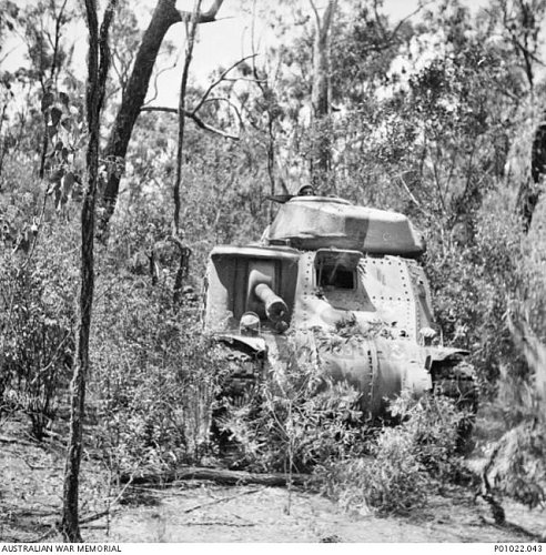

  #77
Old 26-08-14, 02:34
[user name reset]
Join Date: Oct 2012
Posts: 392
Thanks Tony I look forward to those Photos. I have that picture of the Stuarts on exercise and had a look at a copy down in canberra and couldn't say for certain if they had disruptive or not.
They look all green to me and other photos from the same time seem to confirm that. ...But why the Stuarts would miss out when the Grants did not is a mystery and why in all the photos of the grants heading north to Murgon there are no Stuarts is likewise a mystery.
This AWM shot of the 2/4 tanks entrained at Murgon on the way to the exercise doesn't help.
So where are we at?? The colours are standard but the painting is not??? That seems to be the case so far. Does this fit in with the order that gives latitude for colour selection according to location??

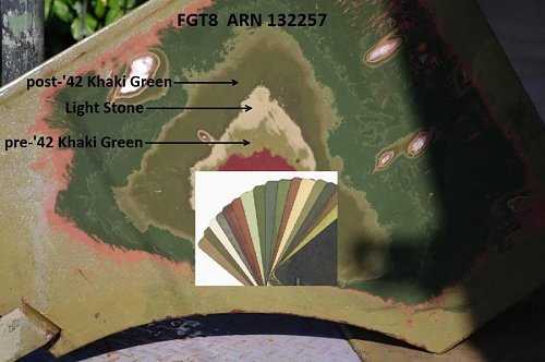

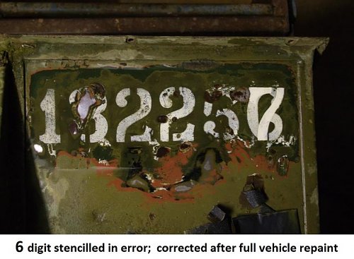

You're right Darryl, the colours have been listed somewhat out of order by AWM. Also they've misspelled "slate grey" as "salt grey". I notice various inconsistencies exist in these tablets concerning the range of colours approved for use, owing to constant revision, however the colours of concern to us appear to be confirmed on the FGT8 door, with the tablets having been revised in respect of Khaki Green, which was darkened in late '42.
Standards Association of Australia. N.S.W. Camouflage Paints Committee. September 1942
11th. meeting of Committee, it was advised that the standard range of colours was to be amended as follows:-
1. Additions
Extra Dark Earth Ex T
Dark Grey (new colour) G
Warm Sand O
2. Modified
Khaki Green J To be darker.
Dark Green M Slightly darker.
3. Removed
Light Slate Grey B
Slate Grey C
Dark Grey D
Purple Grey E
Light Green H
Australian Emergency Standard No. (E)2K. 509-1943. January 1943
Revision of schedule first published in December 1941, and amended in February, 1942.
Six of the original colours have been omitted and three new colours added, while some of the original colours, notably Khaki Green, have been modified. These changes were based on twelve months experience in the use of the schedule in the field.
The standard colours for camouflaging paints shall have the letter designations and names given below:
Standard Designation Standard Name.
Letter.
A .. .. .. .. White
G .. .. .. .. Grey
H .. .. .. .. Light Green
J .. .. .. .. Khaki Green
L .. .. .. .. Scrub Green
M .. .. .. .. Dark Green
N .. .. .. .. Light Stone
O .. .. .. .. Warm Sand
P .. .. .. .. Light Brown
Q .. .. .. .. Darwin Stone
R .. .. .. .. Red
S .. .. .. .. Basalt Red
T .. .. .. .. Dark Earth
XT .. .. .. .. Extra Dark Earth
U .. .. .. .. Night Black
W .. .. .. .. Light Earth

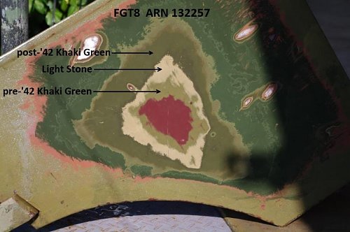

Name:	FGT8  ARN 132257 - Copy.jpg

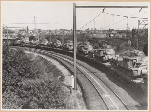

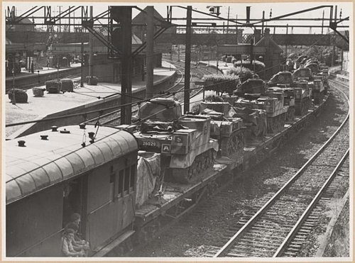

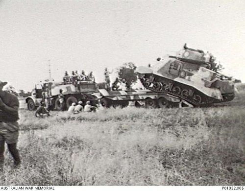

  #81
Old 26-08-14, 20:19
Join Date: May 2012
Posts: 953
Maybe the 2/4 did entrain from Murgon and this it how the 13th new the line was too light .
Yes I agree with that conclusion Gina. The series of 47 AWM photographs catalogued P01022 was donated by H. Jackson, presumably Hugh Jackson of 2/4th Armd Regt pictured below on the way to Murgon. It chronicles their epic drive through the bush from Wee Waa (Narrabri) to Murgon, initially attempted with tank transporters which became bogged, and the onward trip by rail to Caboolture, presumably to join the North Coast Line to Gympie. No doubt they got there eventually but the derailment would explain 13th Armd decision to drive direct to Gympie instead. It's an excellent photo essay and a fascinating insight into the difficulties of tank transport at the time.
Well done spotting camo on the overturned Stuart, it's good to have corroborating evidence of disruptive paintwork on Stuarts. Once again it's difficult to judge the colour, and comparison with the Cab 12 doesn't help because it's canvas.
Logically these 2/4th tanks would have received Light Earth disruptive, however this particular series of photos calls that into question, and certainly the Grant on the tank transporter appears to be Light Stone, freshly painted like the others it would seem. If so then perhaps it was a question of paint availability. This was a rather busy period for Armoured units, constantly on the move and preparing for possible deployment to NG, so there would have been limited opportunities to repaint vehicles, and they may have used whatever stocks were available at the particular location and time. Also the official change to Dark Green / Light Grey in November '42 would introduce further delay/disruption to supply. Not sure why Light Stone would be any more readily available, however it was certainly produced in far greater quantity than Light Earth, having been in use for a couple of years as opposed to three months, so perhaps there was residual stock in some of the Advanced Ordnance Depots. Ultimately it was a GOC decision, based on suitability for terrain, but it can't be assumed the currently approved colours were always readily available.
On the other hand the possibility exists that we are in fact seeing the currently approved scheme on these tanks, namely Dark Green / Light Grey. The vagaries of colour rendition in B&W processing make it difficult to rule out completely, and evidence of this scheme can be found as far away as Alice Springs in December '42.
Name:	P01022.003  NSW OR QLD, C. 1942. NO. 1 TROOP, C SQUADRON, 2-4TH ARMOURED REGIMENT, WITH GRANT M3.jpg
NSW OR QLD, C. 1942. NO. 1 TROOP, C SQUADRON, 2/4TH ARMOURED REGIMENT, PICTURED WITH A GENERAL GRANT M3 MEDIUM TANK WHICH THEY WERE DRIVING FROM WEE WAA IN NSW TO MURGON IN QUEENSLAND. IDENTIFIED ARE, BACK ROW LEFT TO RIGHT: LIEUTENANT ALAN PROUSE; SERGEANT GIB STUPORT; UNKNOWN; UNKNOWN; GEORGE RICHARDSON; HUGH JACKSON; ALEC EVANS; ALAN ROBSON. FRONT ROW: JACK MCKAY, FRANK MORROW; JIM CHRISTOFF (BEHIND); DAVE WALLIS (FRONT); RON CLAXTON; REST UNKN0WN. (DONOR H. JACKSON)
Name:	P01022.005  NARRABRI, NSW, 1942. Loading Grant M3 tanks for transport to Qld.  Owing to transpor.jpg
NARRABRI, NSW, 1942. AUSTRALIAN GENERAL GRANT M3 MEDIUM TANKS BEING LOADED ONTO TRANSPORTERS FOR TRANSPORT TO QUEENSLAND. AFTER CONSIDERABLE TROUBLE WITH THE TRANSPORTS BOGGING AFTER HEAVY RAINS, THE TANKS THEMSELVES WERE DRIVEN MUCH OF THE WAY TO MURGON. (DONOR H. JACKSON)
  #82
Old 27-08-14, 00:51
[user name reset]
Join Date: Oct 2012
Posts: 392
Tony that Grant Transporter photo sure looks a lot like my Stuart Green/Light stone pattern .

I attempted to rub back a spot as you suggested. I did not manage to get as clean a circle of colours as you have but your method gives me a better indication than my previous efforts.
so I have in order of layers.
Yellow etch primer
Grey primer
Factory applied British Dark Green
Australian applied 1942 Khaki green (J)
Light Stone (N)
Modern Australian Khaki ( Me)
The News for me is :
1 the etch primer same as aircraft etch so far as it looks.
2 That the Stuarts were not US lusterless Olive Drab on arrival in Australia they were British Dark Olive green .. Because they were a part of a US lend lease contract to the British and prepared to a British spec.
This makes the photos of the unshipping of the Stuarts more understandable. It also explains why My Stuart arrived in Australia with a British "T" number painted on it and not a US "W" number. It also explains why the weird shipping numbers and symbols do not gel with any information about US Units or shipping . I need to look to British information not American.

Nice work on the paint layers Gina, your photo displays the full paint history well, with Khaki Green identifiable as post September '42. Photos like this are an important part of vehicle provenance and widely underused by restorers IMO. It's possible to achieve more clarity but it requires many hours of fiddly rubbing work to isolate the colours completely. I find the only way this can be done is by using folded pointy corners of wet and dry to achieve the necessary precision, which is even more difficult with highly uneven paint coats like the Light Stone on your Stuart. I did a lot of that kind of delicate work on the front shell and it reminded me of archaeologists using tiny paintbrushes to reveal fossils!
Name:	IMGP1791 - Copy - Copy.jpg
Name:	IMGP1773a - Copy.jpg
Such photos also provide important evidence of general practice at the time, like the US Lend Lease factors you identify Gina. As such they can challenge our assumptions and go a long way to explaining wartime photographs as you say. I wonder if the Stuarts seen below were rushed into service in British green. It's possible they're seen after rainfall but even so they look way too dark for pre '42 Khaki Green.
Name:	0_2789000 State Library Vic.jpg

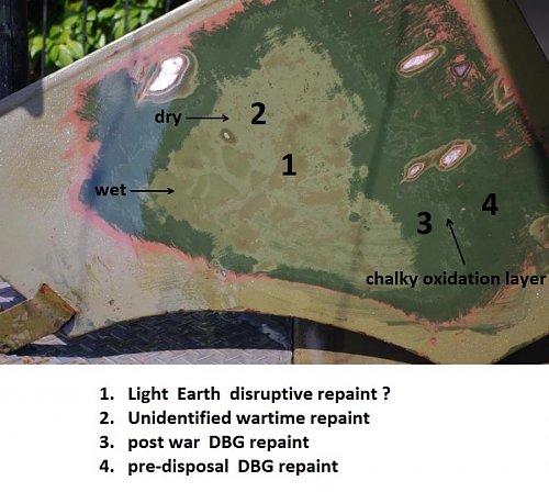

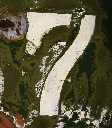

In due course I'll resume work on the FGT door to expose the required colours for matching. Unfortunately I got a bit carried away last time and removed too much paintwork, however there's plenty left to work with I believe. Ideally each coat needs to be exposed individually to provide maximum area for colour matching, and sealed with clear satin for colour rendition. Colours worth matching on this panel are pre '42 Khaki Green, Light Stone, and subject to confirmation post '42 Khaki Green and Light Earth. As such it will be a lengthy exercise but it's the only way to replicate these colours with full confidence. Hopefully it will be of use to others and can lead to standard formulations being established, which if confirmed by reference to WWII paint chips would be fully authoritative. This work has been done for modellers but does not translate usefully to volume supply. Ideally we can reach a point where WWII paint can simply be ordered, with paint matching a thing of the past. Hopefully my own efforts will be a step in that direction, to which end I'd welcome any suggestions/advice concerning suitable paint types and suppliers. I gather the general preference is for enamel rather than acrylic. Protec is one name that springs to mind and may be ideal for this project, given their association with current military paint supply.
Name:	TONY5120 - Copy - Copy.jpg
Name:	FGT8  ARN 132257.jpg

These pics show 3rd Armd tanks in Khaki Green / Light Earth camo, including a Stuart it would seem. Note the difference in bright sunlight, very similar to 2/4th Grant in the bush. Official timeline for this scheme was 28 July to 14 November, with Khaki Green darkened in September.

Name:	P01022.043  NSW OR QLD, 1942.  2-4TH ARMD REGT GRANT M3 MEDIUM TANKS EN ROUTE TO MURGON QLD FOR .jpg

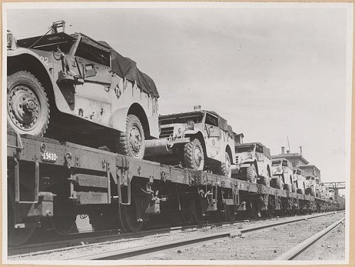

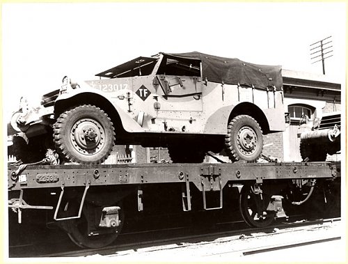

Scout cars for Darryl's interest, which I believe are also in Khaki Green / Light Earth. Low contrast suggests pre '42 Khaki Green.
Is it my imagination or have they sprayed this with the spade in place?
Name:	nsw.gov.au 17420_a014_a014001313.jpg
Name:	nsw.gov.au 17420_a014_a014001311.jpg

Tony - I think you are right about painting with the spade in place on that scout car. I have blown the photo up a bit and it certainly looks that way. So you reckon that is light earth on the scout car and not light stone? I must admit my uneducated eye can't tell the difference on these black and white photos. I had been leaning toward light stone for my paint pattern but light earth might be more appropriate.
I don't see the light earth in the paint sample plates listed. Am I right in thinking the light earth doesn't appear in those paint samples because it was added in January 1943? Is/was there then a set of paint samples which have all these new colours?

Tony
The photo is from NSW railways collection, tanks passing through Homebush ( the station is near me and those buildings and the pedestrian bridge still exist) the train is heading south.
Photo was taken 7/2/1944. By that time My stuart and the rest of the 13th tanks were in Bandiana or heading there for storage.
Homebush is near chullora and the tank workshops associated with the manufacture of the sentinels.
The Grants have the late camo scheme my guess is they are on the way to bandiana sans guns for long term storage. There are no unit signs so it could be either the 2/4 or the 13th tanks.
There is a photo earlier in this thread of a grant at bandiana taken about the 5th 1944 with the same scheme as those in your picture
If it is the 2/4 they would be tanks being returned to store as that regiment was reequipped with Matildas and joined the 4th armoured brigade and went on to serve in the Islands.
Photo evidence has the 4 armored Brig still equipped with grants and matildas in 1945 when they were disbanded at southport. So perhaps those on the train are the 13th
The 13th was disbanded completely on 19 Oct 1943 and its vehicles returned to stores.
The photo taken nearly a year after the 2/4 made the epic trip from Wee Waa to Murgon and then as a part of the 3rd down to Bribie island has them in Light stone and Khaki as my tank was painted at the time. In the seven months between the exercise around Bribie island and the time this photo was taken it appears the tanks were repainted.
1 grants in storage 5/44 2 and 3 Grants and matilda of the 2/4 being loaded at Southport for Bandiana after the disbandment of the 2/4 3Jan 1946
Actually I should have been less categoric on that point, I've amended the wording accordingly. As you say Darryl it's extremely difficult to pick Light Earth from Light Stone in B&W photos, especially in bright sunlight. Other factors include freshness of paint, distance from camera, and photography itself. For example, the same photo with different exposure and/or processing would lead me to conclude Light Stone.
Name:	nsw.gov.au 17420_a014_a014001313 - Copy.jpg
ID:	67497 Click image for larger version
There needs to be something of known colour in the photo for comparison, and in close proximity to the vehicle. White lettering provides a useful point of reference, but the truth is we can only be 100% certain when both schemes appear in the same photo, as seen below.
Name:	[Tanks from New Guinea] nsw.gov.au 17420_a014_a014001330.jpg
ID:	67499 Name:  AWM 065165  Kairi - Copy.jpeg
Other than photographic evidence we only have circumstantial evidence, principally the date of painting, which loosely followed the official instruction timeline:
Khaki Green / Light Stone 2/1/42 - 28/7/42
Khaki Green / Light Earth 28/7/42 - 14/11/42 (Khaki Green darkened circa September '42)
Dark Green / Light Grey 14/11/42 - 4/3/43
Three tone scheme 4/3/43 - 28/7/44 (yet to be sighted in photographs)
In practice however we need to consider various probabilities. Light Stone was a British colour intended for desert use and was applied in Australia to vehicles bound for the Middle East. As such its subsequent use as a disruptive colour for SWPA seems to have been largely a matter of expedience due to urgency. Presumably it was soon found too light for vegetated terrain and subsequent changes reflect efforts to darken the overall scheme whilst achieving the necessary contrast for disruptive effect. Logically therefore you'd expect Light Stone to be discontinued in production without delay, and certainly this appears to have been the case with CMP production, with vehicles emerging thereafter in Khaki Green only, including gun tractors it would seem. Evidence suggests Light Earth was introduced in production for armoured vehicles only, and where seen on softskins it has been applied in the field.
Based on these considerations the appropriate scheme for a White scout car would revolve around the delivery date. In other words, Light Stone would only be appropriate before July '42 delivery or thereabouts. It's also true that Light Stone was widely overpainted in the field, particularly on tactical vehicles, so it's entirely appropriate to use Light Earth when depicting early vehicles in the field after July '42. The FGT door seen above is an example of Light Stone being found unsuitable.
As you say Darryl the AWM colour set does not include Light Earth. This is one of the inconsistencies I referred to earlier concerning the range of approved colours, owing to constant revision. The caption mentions another set: A note attached to a different set of the same colours states: "First issued December 1941; Amended February 1942 ; Revised January 1943". It's possible this set may contain Light Earth, and a couple of sets exist in private hands as well. Hopefully the FGT door will provide a satisfactory example for matching. We certainly need this colour as it was widely used at the time, particularly on tactical vehicles, and once painted it remained there until camo became obsolete in July '44, and in operational areas until the end of the war.
I'll have a look through my saved images for scout car camo schemes.

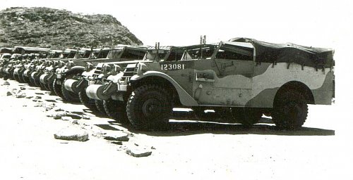

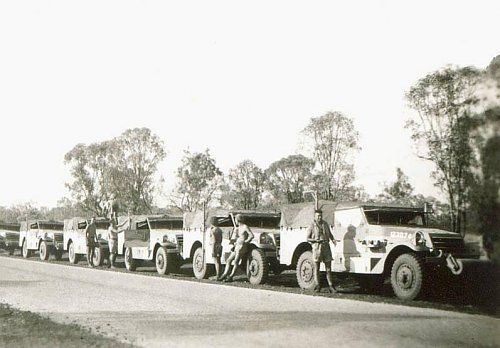

These pics show scout cars en route north from Alice Springs, and once again I believe we're seeing Light Earth disruptive freshly painted. I notice the ARN range is the same as the one seen on rail car in NSW.
Name:	White scout car convoy Alice Springs.jpg
ID:	67501 Click image for larger version
Name:	White scout car Alice Springs.jpg
ID:	67502 Click image for larger version
Name:	White scout car convoy main north south road  121 Australian General Transport Company.jpg
