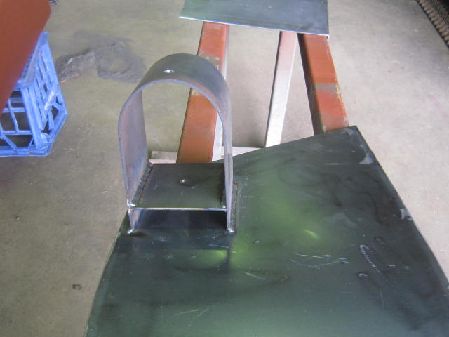

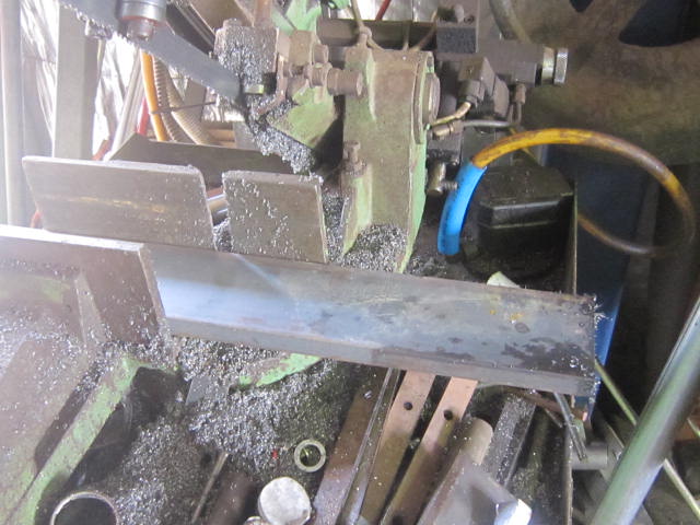

A bit more of the guard and my apprentice sweeping and his reward is a swing on the overhead gantry

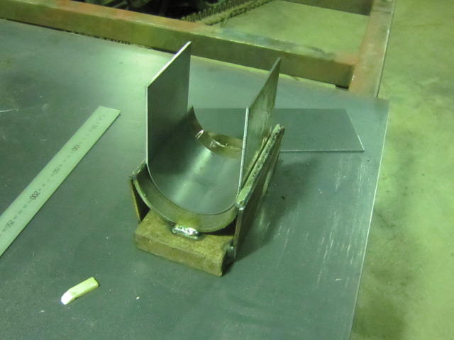

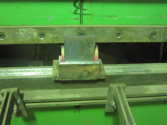

Another press tool for the headlight bracket

some more of the guards

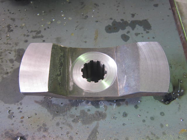

Hi all, I thought I had a spare one of these but I don't. I had the coupling and the diff side of it but not the trans side. One is no good without the other so I had to make one. I started with a piece of 75x16mm plate, cut it over length, made a quick set of press forms and with the aid of some heat I bent it to a 16mm offset. Sorry I never took any early pics

The female spline came off a tailshaft which I put in the lathe and machined all the unwanted material and cut a recess to the end so it fitted perfectly into my plate. I welded a piece of round pipe to the centre of my plate which allowed me to fit it into the lathe, bore a hole in the centre and machine the 2 surfaces parallel to make the 2 pins sit vertical

After I welded both sides of the spline socket to the plate I put it back on the lathe and machined the centre back so the washer and nut can sit flush to the trans shaft. The pins are welded both sides and ground back. After all that I gave all of it some cosmetic grinding but was very carefull not to grind off to much weld. A coat of paint and that's it.

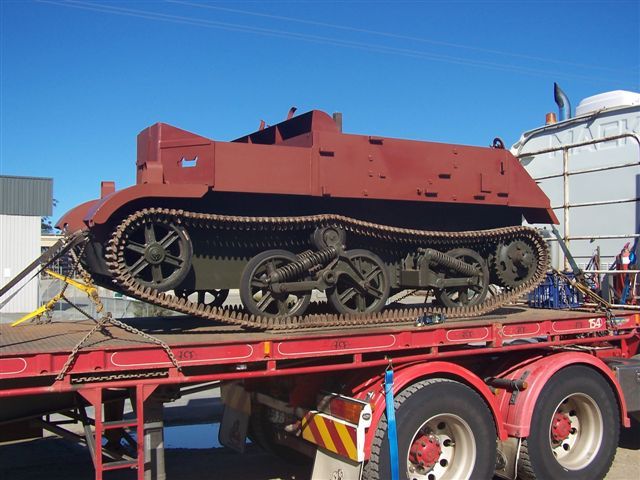

It's all packed and getting loaded to head East.
VR2225 FINAL 002.JPG   VR2225 FINAL 003.JPG   VR2225 FINAL 006.JPG   VR2225 FINAL 007.JPG   VR2225 FINAL 010.JPG

Well that's it. It's on, chained down and on it's way. I will look forward to
"2225 alive"
Colin.
THE END!
VR2225 FINAL 012.JPG   VR2225 FINAL 014.JPG   VR2225 FINAL 023.JPG   VR2225 FINAL 025.JPG   VR2225 FINAL 028.JPG

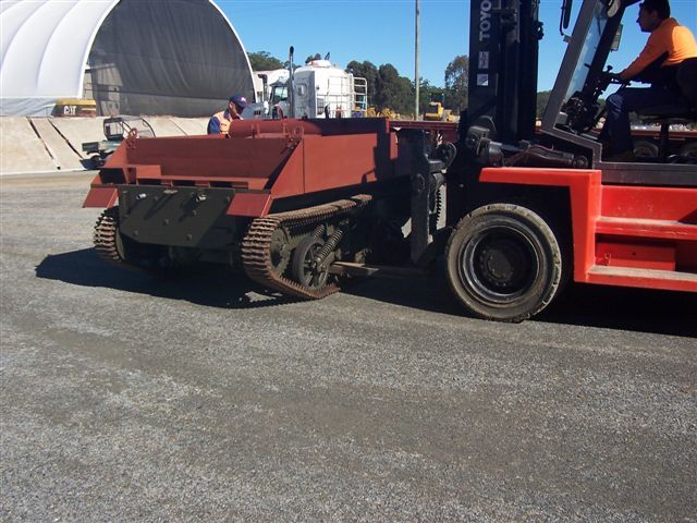

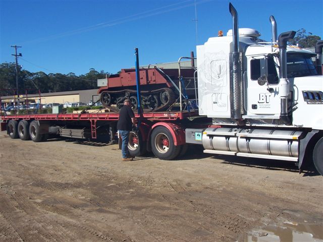

Vic rail 2225 has made it to it's new home very long trip from Adelaide to Port Macquarie very quick time two days nice friendly truck driver which was great . lifted it off with a 10 ton fork lift then tilt tray to me ... Dale
