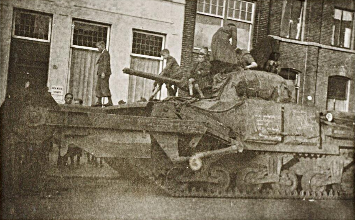

Old 10-10-20, 17:53
"The story of Westminster Dragoons" sadly doesn't have too much detailed info on the battle in Broekhuizen, but I have to read the rest to see if it includes any info on census numbers and nicknames of tanks.
My previous comment on the "story of the Westminster Dragoons" was a bit blunt. Contrary to what I wrote, it does have detailed info on the battle of Broekhuizen, but it doesn't include names and census numbers of tanks I was looking for, and limited info on crew names. It is however a very interesting read and available online in PDF form.http://www.westminsterdragoons.co.uk...pe_1944-45.pdf
It lists that no.4 troop A squadron under command of William Hall was in Tilburg from 28 to 30 October, with 5 flails and a Command Tank manned by Capt. Squirrell. I found the pictures attached in the local Tilburg Archive, which has to be this group
Even though we now know that Avalon is not in this troop, but in no.2 troop in stead, I decided to post the images, as they give a nice view of the storages boxes and extra chains on the side of the hull, just like the one fitted to Avalon.
I actually think the left hand side box on Avalon in the early museum days was an ex-wading stack used as a box for spare chain, which I think I have seen on more Crabs, especially during the fighting in Normandy.
source:https://www.regionaalarchieftilburg.nl/zoek-een-foto/
Screenshot_2020-10-09 012238.jpg   Screenshot_2020-10-09 012237.jpg   Tilburg1.jpg   Tilburg2.jpg

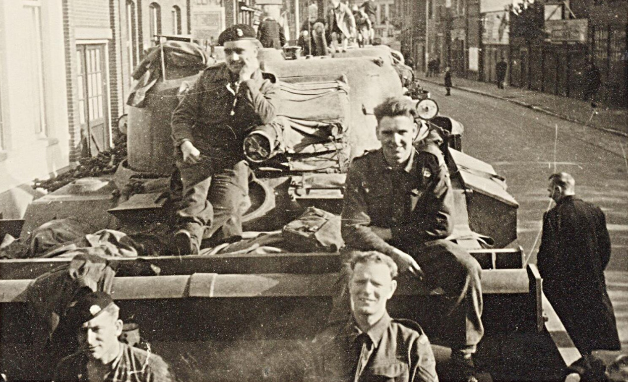

Old 12-10-20, 22:50
MicS MicS is offline
(Michel Sabarly)
Join Date: Sep 2007
Location: France
Posts: 104
Default Lt Hall's Troop in Tilburg
Great photos of Lt Hall's 4 Tp in Tilburg Alex!
All 5 Crabs are visible, led by Lt Hall's. He is the one with the moustache, leaning on the gun on this photo:
Name:	012238 - Crabs 4Tp A Sqn WD, Bredaseweg Tilburg, 27 Oct 44 - RA Tilburg - Ls WS Hall leaning on .jpg
Just ahead of his tank is another Sherman which must be Capt Squirrell's command tank. The stowed jerrycans on the left rear of the tank might mean it is the same tank as on IWM B10819, although of course the other command tanks in A Sqn might have used the same stowage method:
Name:	012236 - Crabs 4Tp A Sqn WD, Bredaseweg Tilburg, 27 Oct 44 - RA Tilburg - Notes.jpg
Finally, the second Crab in the line might have a name on its side, but the graffiti and low quality of the photo make it completely illegible:
Name:	012237 - Crab 4Tp A Sqn WD, Bredaseweg Tilburg, 27 Oct 44 - RA Tilburg.jpg
Michel
  #77

  #81
Old 14-10-20, 13:01
Join Date: Feb 2004
Location: Beek Holland
Posts: 425
Yes Yakko , you are right if the driver , and co driver would lift up their arms , we could see it , direct vision didn`t have the periscopes in front of the hatch.
  #82
Old 14-10-20, 16:26
(Michel Sabarly)
Join Date: Sep 2007
Location: France
Posts: 104
Agreed, but to me the relatively high position of the plates means they can only be welded to Direct Vision hoods.
Michel

  #84
Old 15-10-20, 00:37
Thanks for the confirmation Michel!....I was presuming Hall was in the picture, I just wasn't sure which one he was.

here is another one , maybe been on here before .
Terrific picture Maurice! Any idea when and where it was taken?
I am betting on a direct vision hull as well. Attached is a picture of another "mysterious" Sherman, Argyll Roger (or Argyle as it says on the side today!) from a similar angle for comparison
  #86
Old 15-10-20, 20:43
(Michel Sabarly)
Join Date: Sep 2007
Location: France
Posts: 104
Supposed to be Kampen NL in 1945 according to this:
https://beeldbankwo2.nl/nl/beelden/d...717b464/media/
Michel

this flail could be Avalon , look at the mounting position of the track links on the turret , just it still has the cover on the front of the flail drive with 53 and 79th on . But off course there are more tanks with spare links on the turret .
  #89
Old 22-10-20, 13:06
(Michel Sabarly)
Join Date: Sep 2007
Location: France
Posts: 104
Maurice,
It cannot be AVALON, although the spare track links disposition does look similar. But the tanks have different types of commander's sights, i.e. the blade type sight on the photo with a group of troopers on it, and a vane type on AVALON:
Name:	Crab WD - Notes.jpg
Name:	AVALON - NationaalArchief2 - Notes.jpg
For more info on these two types, see (as always) the Sherman Minutiae page:
http://the.shadock.free.fr/sherman_m..._variants.html
Michel
  #90
Old 22-10-20, 15:37
Join Date: Feb 2004
Posts: 425
Yes I see , no weld remains left
But be careful , some turrets (I have 2) have both types mounted .
