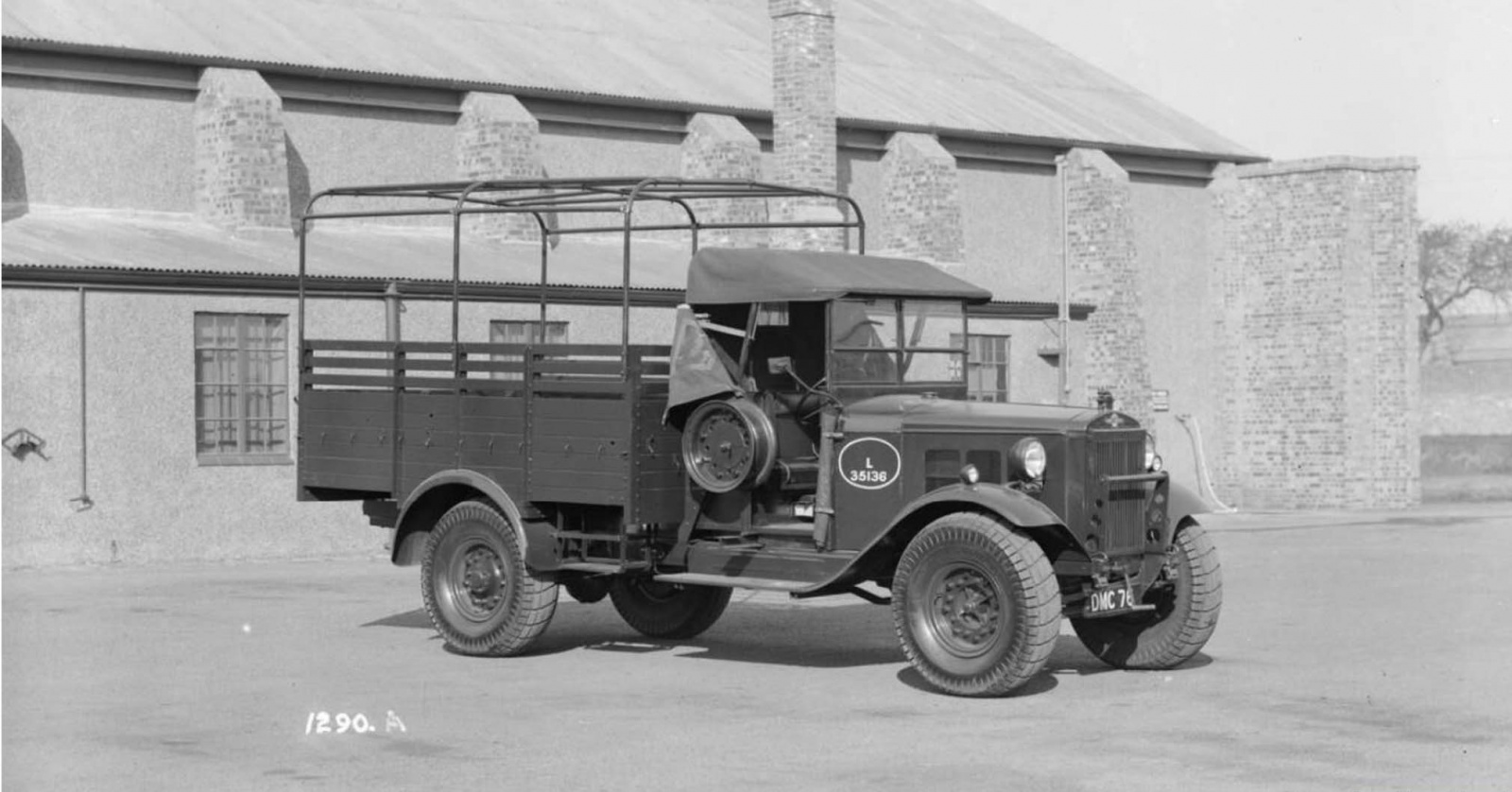

Old 12-10-25, 21:01
Konstantin Chernov Konstantin Chernov is offline
Join Date: Aug 2016
Location: Ukraine, Dnepr city
Posts: 74
1.The truck looks a lot like a Crossley, but what model is it? The cab layout is similar to the Thornycroft A5 for India http://www.mapleleafup.net/forums/sh...51&postcount=2. The radiator guard has two crossbars, and the design is similar to that installed on the Crossley IGL6 and IGL8.
2. Crossley IGL6 http://www.crossley-motors.org.uk/hi...IGL3/IGL3.html
3. Crossley IGL8. British Military Transport 1939-1945
