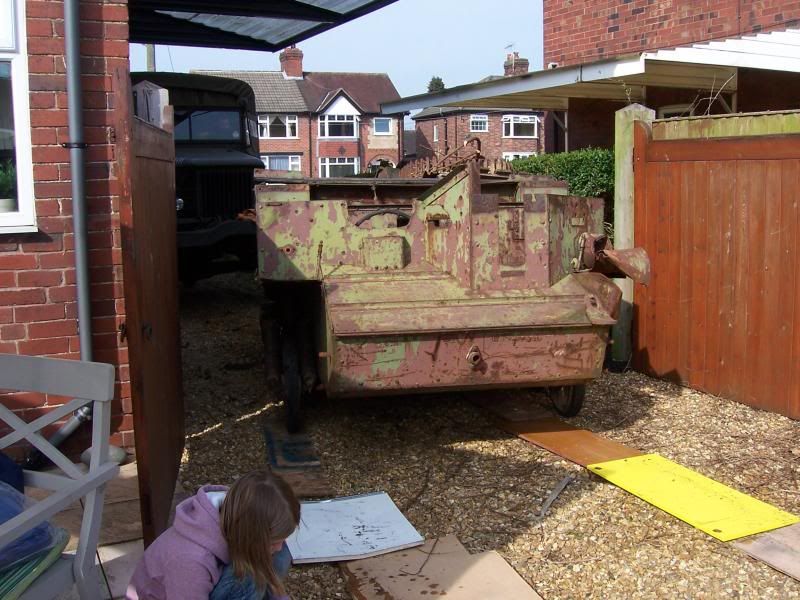

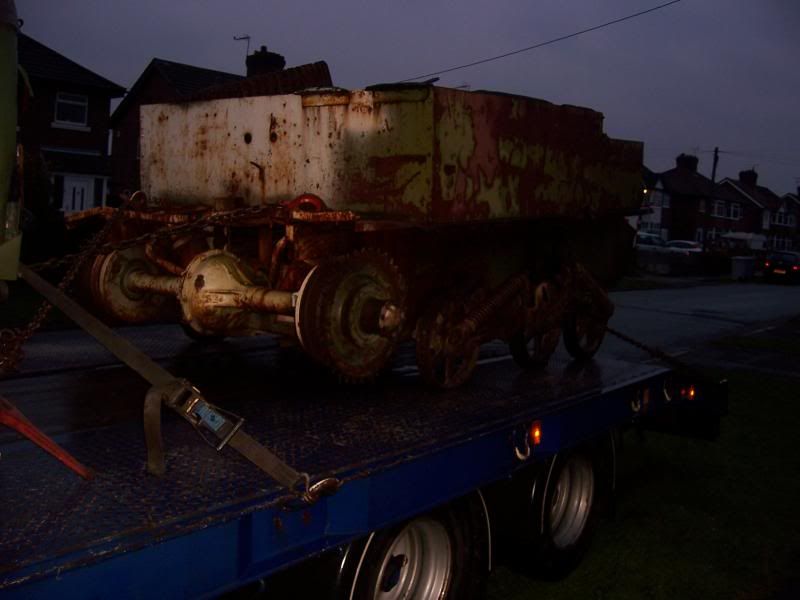

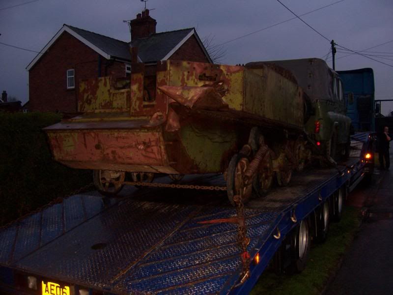

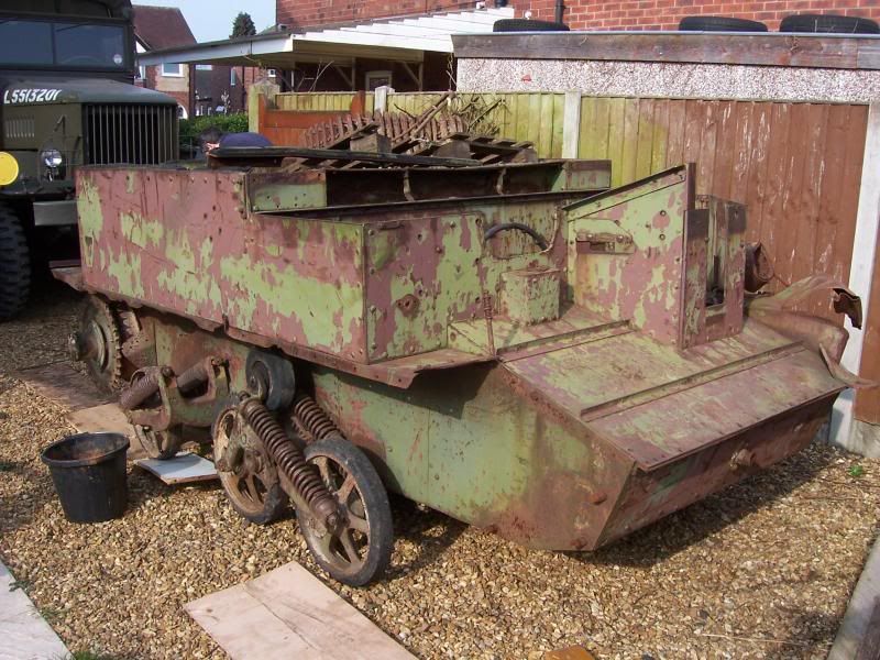

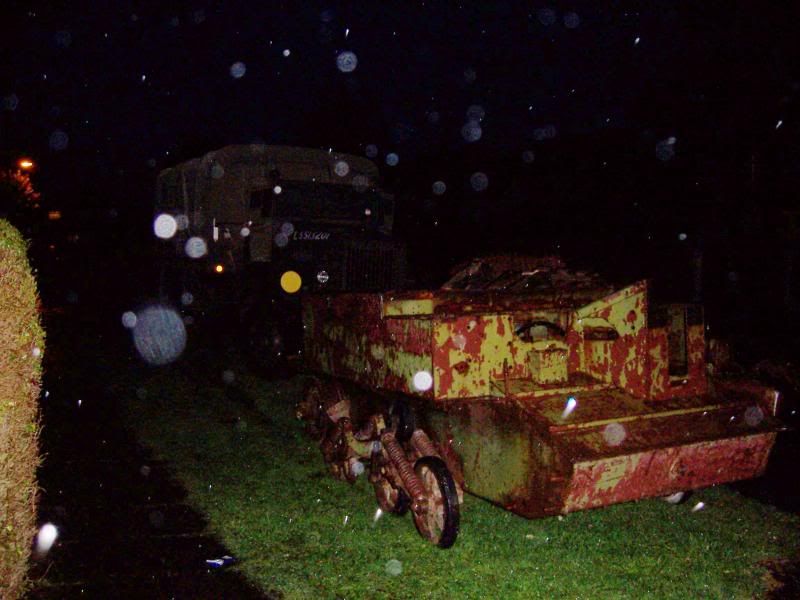

Hello,

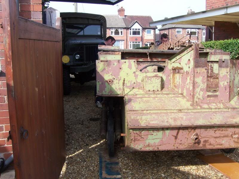

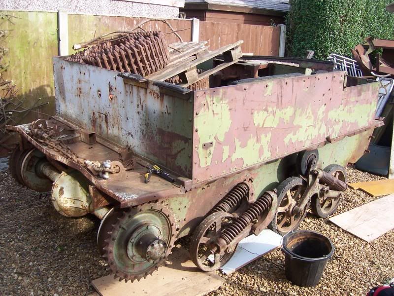

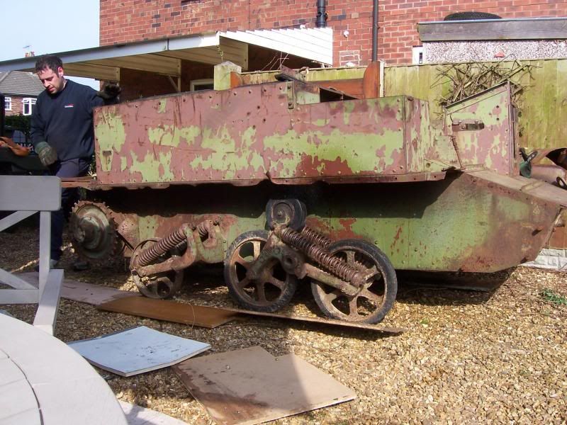

Here's some pictures of the carrier i have just got for restoration.
I'm new to the carrier world, so any help and advice would be gratefully recieved. Really happy with what i've got, most of the armour is complete and not to rotten. Can spend the weekend looking at what else i have.
John

Well its a lot better than a new kitchen me thinks bet your pleased its home looks like it'll keep you out of any more mischief for a while, good luck with the resto I look forward to more pics in the daylight.

Mega jealous John.... I could only dream of having that much armour left !
Welcome to the family.

Hi John, that is a good project ! A friend just up the road from me bought the other carrier from Hughes.
Looks like they were both stripped and cut to the same degree. It should not take long to do .

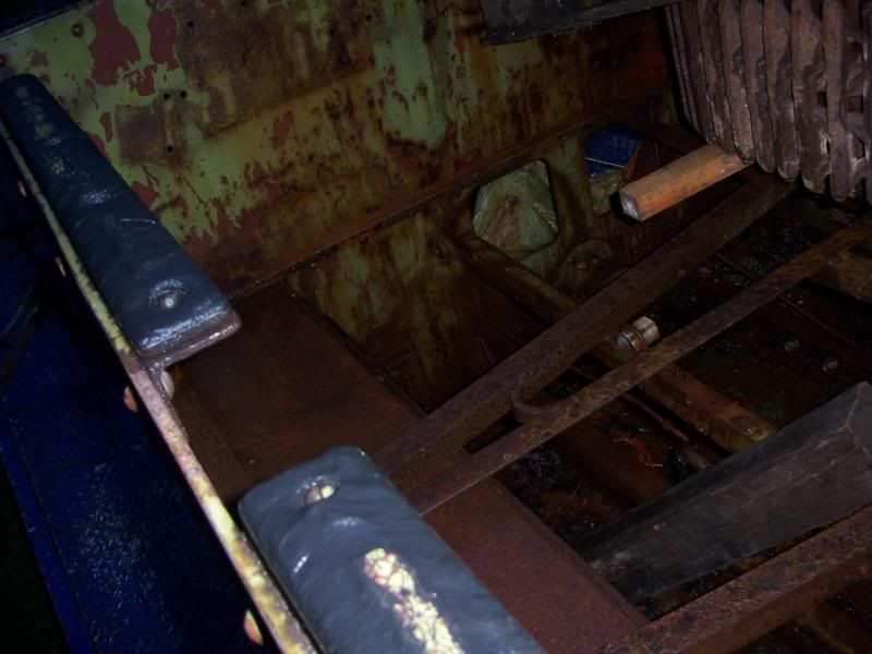

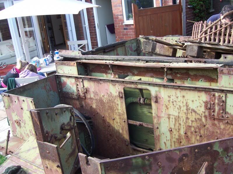

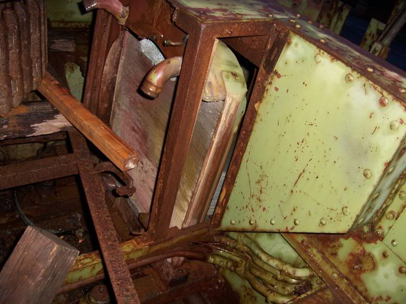

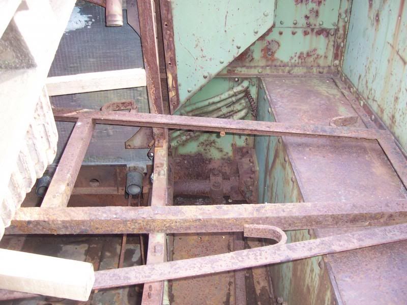

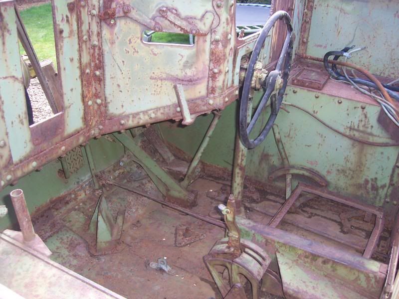

Hello,
A few more pictures of my carrier. Had a lovely sunny day today, so started cleaning out and having a look at what i ha bought.
Why is there a block of wood bolted to the hull by the side of the engine?
I seem to be missing some links of the steering mechanism?
Filled a couple of buckets of soil from it today, found a number stamped in the metal behind the passenger seat. Hull number i think? Where will the other be? and is there any chance i can find the wd number from them?
The drivers side of the hull has been drill in two places with four holes each, can anybody recoginse these?
Please P.M. me if you have any of the parts i'm missing, i have got the front idlers but the rest is yet to be found begged borrowed and remade.
john

John make a list and we will help best we can, you have my details matey dirk Leegwater has complete nos dash built up.... Hopefully Kevin helped you out and you got the dash panel at a good price.
Regarding the holes, If it's at the rear end of the lower hull it's for the fuel tank straps.

If it's the four that are in a diamond type
Format, looking at your pics in your album, it's for the smoke discharger bracket

Yes that the ones richard. This picture shows them, there are also four behind them?
thanks

The four at the rear end near the top of te armour are for the radio antenna bracket ;-) the four near the front above te discharger holes are for the bren pintle mount
What your going through now is what I loved the most about carriers ! Learning what everything was etc etc !

Hi John, and welcome.
The bad news is that your hull number is gone with the piece cut from in front of the driver. Any chance of tracking down the cut out piece?
Regarding the holes at the right rear (Aerial mount) Nigel Ward made them. there is a long thread about them if you do a search.
I see the division plate Bren mount (pintle mount) bracket laying on your inner guard (track guard)
She looks like she is in great condition. It would be great to be able to start from there.
Don't be scared to ask questions, and keep the photos coming.
