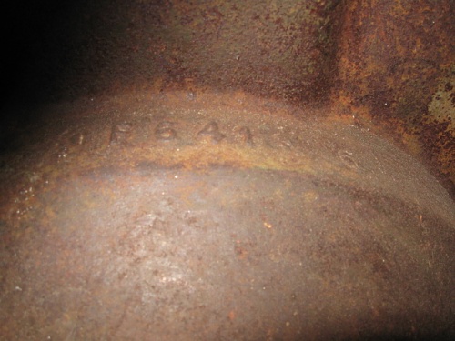

Can anyone help me with the identification of my ford v8?
Serial number D363:1 K
Pretty sure it is not the original engine? Hope somebody out ther can help!

Hi David,
Welcome to the forum! Always great to have new members onboard and to hear that another Ford CMP truck has been saved from extinction.
I cannot offer any info based on the s/n but a photo of it would help to identify it.
As a general rule, the raised casting number and letters on the right front side of the block and/or the bell housing will give you the date the block was cast. If you post them I can identify it for you. It would be something like "C..9A"
There are some Blitzes around that have been retro fitted with earlier 21 stud motors which automatically rules it out being the original, likewise the later 8BA engines with the separate bell housing, top mounted distributor etc.
Car engines were often substituted for the truck engines over the years so things like single sheave pulleys on the crank, water pumps, and generator indicate a passenger car engine. A 1944 CMP truck would have used double row pulleys.

Likewise welcome here David.
Have a look on top of the valley machined surface for an engine number as well. The original engines for a 1944/45 model was 4G with a F suffix.
Out of interest the original engine number is usually stamped on the top go the gearbox housing and also on the right front chassis next to the engine mount, this doubles as the chassis number.

4G6532F is the number given on the data plate....see pic. The number on the casting on the bell housing is D363:1 K. Engine does have the divers helmet fitted. Mmmmmm need to find more numbers on the engine. I'm beginning to think it was a quick fix by putting another motor in it?
Hi David,
After zooming in on your photo of the engine I would say it probably was a engine swap with an earlier passenger car engine based on the single row water pump pulleys and what appears to be an alloy intake manifold. Neither would have been used on a 1944 built truck engine.
That number has me intrigued though. Is it raised lettering and cast into the block or stamped into the block? If raised lettering it does not conform to any block ID I could find. Still, there are a few strange ones out there which may not have been documented. If stamped into the block then some administration may have done it for their own ID purposes.

That number you quoted "363:1 K" is that in raised lettering in either of the positions that "C69A" is shown on my engine block? Anecdotally, I have heard there were some odd block codes for things such as stationary engines but have never seen any documentation on such.

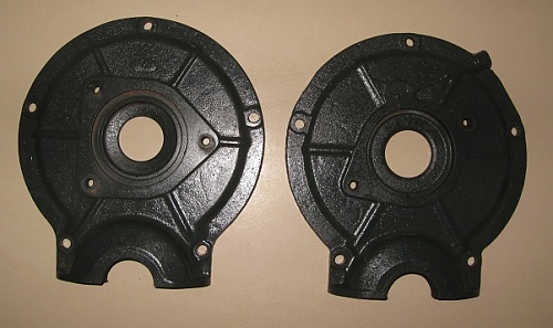

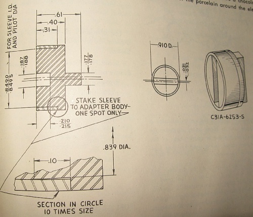

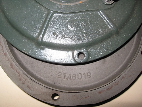

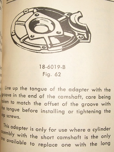

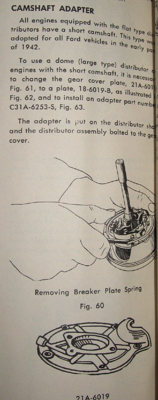

Hi Mike,
Attached is the 3 bolt divers helmet distributor to a crab distributor adaptor plate I mentioned.
Looking at it, and the description, a cam button spacer is needed for some stock shallow cam noses.
So perhaps the other way to use an earlier distributor on a post war engine and vice versa is to also change the timing gear cover. Again, I am not sure if this is possible so perhaps another person can enlighten us. I agree, I don't know why one would want to use a divers helmet distributor as opposed to a crab distributor on a later engine but nothing surprises me when it comes to the old engines!
So to get back to David's original question, once he inspects the water jacket openings in the block that will be the final arbiter of what approximate year his engine was manufactured. After that it will be easy to decide what, if any, items have been changed from original.

Hi Mike,
http://www.speedwaymotors.com/Flathe...olt,25076.html
The Ford Manuals describe the method to interchange the "Diver's Helmet" and "Crab" distributors. The two timing covers are interchangable, and are the same height from the block to the dizzy mounting surface. 18-6019B has the 3 bolt mounting pattern for the Divers Helmet (and earlier) distributors, and 21A6019 has the 2 bolt pattern for the Crab, the '46-on and the Thames/Lucas styles.
The Camshafts however, are different. A long cam is used with short drive key of the 3 bolt dizzy's, and a short cam with the longer drive key of the 2 bolt style. If you need to fit a "Short" 3 bolt dizzy to a "Short" cam, in addition to swapping the timing cover there is a Ford spacer. If you are fitting a "Long" Crab dizzy to an earlier "Long" cam, then the Speedway style spacer will provide the additional length.
This might be necessary in wartime if you are maintaining a fleet of LP2 Carriers or MCP trucks with the Divers Helmet dizzys, and a replacement engine of the Crab style is supplied. To maintain commonality, you might want to replace the Crab with a Divers Helmet?

Hey guys! Just thought I'd start this thread with: "Can anyone help me with the identification of my ford v8?"
More info and pics to follow!
Originally Posted by Tony Smith
Any progress on finding a stamped engine number, not a casting number?
That number cast into the bellhousing is not the engine serial number or model, it is either a date code or a lot number for the block casting. I have a couple of engines here with similar numbers (Pic attached of "F641"), but have not yet found a way to decipher the codes. You might find the engine model number, 99A, cast near the top of the RH water pump. I've never seen it cast on the bellhousing part of the engine like the US and post-war Canadian examples. As mentioned, the majority of online sources of ID info for the Ford V8 is based on US production, and very little on Canadian WW2 engines.
The engine serial number will be stamped on either one of the 4 available corners of the valley cover mounting flat (or maybe not at all), or on the gearbox bellhousing. See THIS THREAD for an example.
While your engine does have a single row pulley RH water pump, I can also see that it has a double row crank pulley, so I would be willing to gamble that it is still possibly the original engine, or at least the correct truck type, and that someone in the mists of time has replaced that water pump with a cheaper and more easily obtained car pump.
