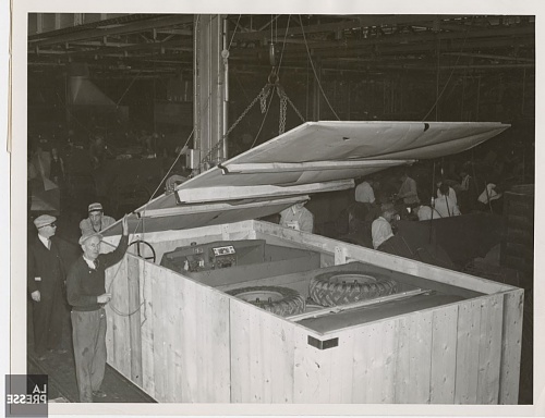

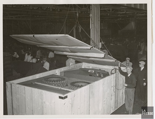

A Cab 11 or 12 CMP in a Single Unit Pack.

Interesting to see these Cab 11 or 12 cowls in Light Stone, while the seats are painted Khaki.
I'd say Cab 12. My first indicator was the valves for the footwell vents. Then I saw the hinges for the opening hood of the Cab 12.
The cases in the background say Chevrolet and the features of the cabs do seem to match Chevrolet (but I haven't checked enough details to be 100% that they can't be Fords).
Old 01-01-23, 23:55
I agree..Chev Cab12's. Excellent picture
Early Ford F15 or F15A cab11 is my best guess. You can see the small radiator cap, Ford dash, and absence of door hooks and knobs for the cab vents.
Old 02-01-23, 00:27
Let me be a dissenting voice. I say Ford 11 cab. The instrument cluster and switches look Ford and you can see a rad cap on the cowl that wouldn't be there on a 12 cab.

I think the photograph needs to be flipped to get the instrument cluster on the correct right side.
Attachment 131950
Good morning Ed,
Are you sure the photo needs to be flipped? Doing so creates an unusual left hand drive CMP (steering column location as well as the packing location of the steering wheel)....

Good morning Ed,
Yeah, looking closer, I agree with you.

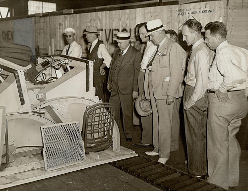

Mariano Paz
Buenos Aires, ARGENTINA
1944 Ariel W/NG
1945 FGT FAT

I notice wood slats located across the ends of the crates and one or two more in the middle, probably depending on the overall weight of the crate. That would allow for a pair of ropes to be fed through to sling the crates with a crane.
I can recall years ago seeing an old black and white news film of dock workers feeding ropes between wooden crates that size and being amazed at how quickly they could do it, but cannot remember exactly how they did it.
