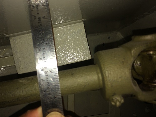

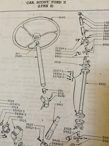

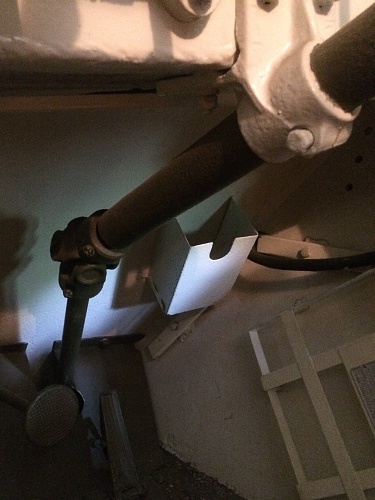

Harry,
The Spare Parts Manual for the Lynx 11 only lists two brackets for the steering gear, 3678 and 3925, which both have the C19SR prefix, which I interpret as being the same as the first marks of the Lynx. The lower steering gear shaft on my Lynx is 3" from the lower glacis plate.
Hope this helps, Peter
