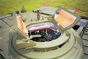

Churchill Commander's Hatch The commander's cupola, showing the padded clamshell hatch covers and the vision blocks. Visible to the rear and rear left are the two antenna brackets for the standard No.19 wireless set mounted in the turret bustle.
