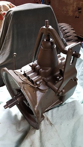

Gearbox and differential almost finished.
Now started with the bottom of the hull.
I received from Simon Delaney a package
with parts as the ventilator boxes and
steps, adjustment parts for the tools at
the rear side.
Marcel.

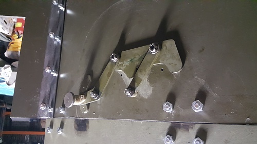

I had make a start with the replacement of the upper armour at my carrier.
At first i mount all the parts with bolt and nut and later with rivets.
My wheels are also done with new rubber.
I had try to upload some photo's of the progress but unfortunately
after resized the photo's and uploaden the photo's are turned upside down.
Marcel.

Greasy side down

Thanks a lot Michael.

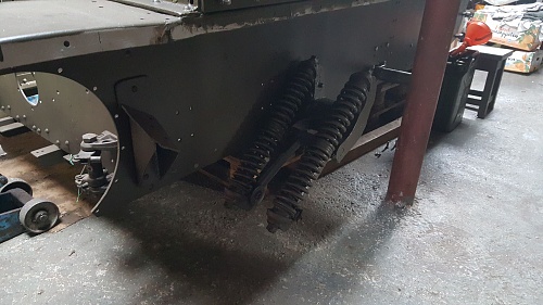

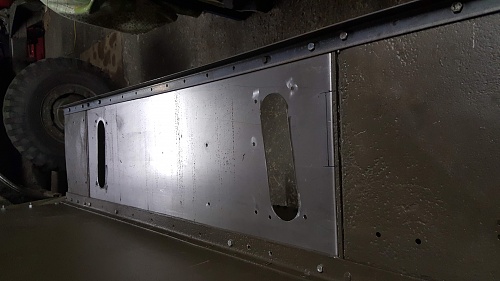

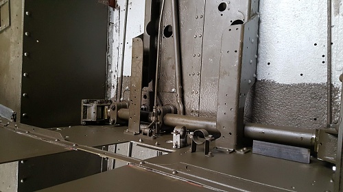

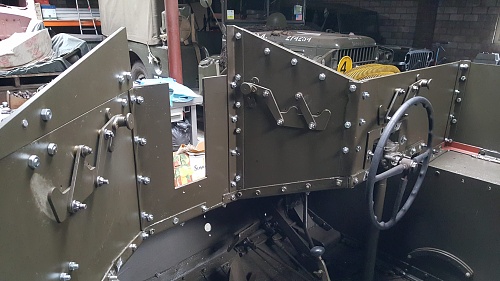

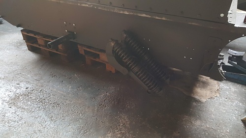

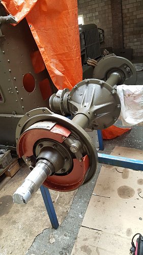

Hi all, it is almost a year ago since my last post here but i am still working on my carrier.
The upper armour will be for the biggest part ready so soon it will be rivet time.
I have put back the cross tube and the rear suspension and now works at the rear deck.
Cheers Marcel.
