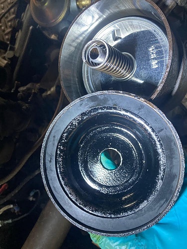

When changing the engine oil filter, one often encounters an old seal on the filter cap. Nick Paulussen in Belgium had a custom batch made by a specialized seal manufacturer. So the seal is made from material to withstand oil and typical temperatures.
I’ve fitted one to my F15A and can wholeheartedly recommend it.
Contact Nick via his e-mail if you want to buy them at €15 each.

Here in Europe, I find that the MANN PF925X filter is a good fit, and it comes with an 11 cm diameter rubber ring which fits in the oil filter housing. Equivalent filters from other manufacturers often have smaller sealing rings. Having a proper flat seal is better, though.

As Hanno has stated, this is a common problem in Europe which we both experienced with our F15A and C15A respectively.
The above mentioned filter fit, but the provided gasket did not.
The previous owner had the same problem, and thus continued to apply liquid silicone sealing kit on top of the original gasket.
Unfortunately during the last oil change, it was ruptured to the point beyond repair.
This prompted me go to go in search of a fitting gasket.
